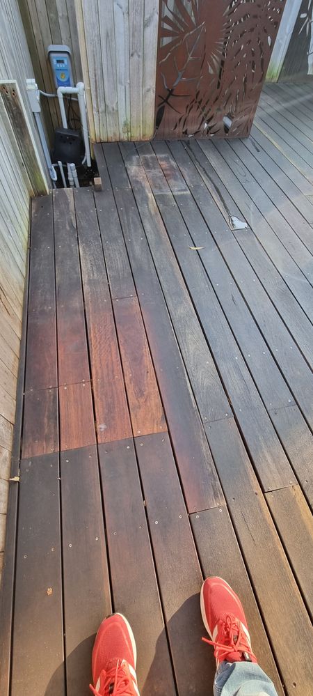

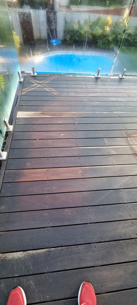

We've just bought our first home, and we've inherited a double deck and pool deck.  The previous owners said I could simply put a new coat of deck oil on the deck, and left the remains of a tin of Cutek oil. The marketing blurb seems to indicate I can do that also.
But on closer inspection and talking with some of the staff at Bunnings, I am not convinced.

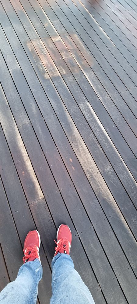

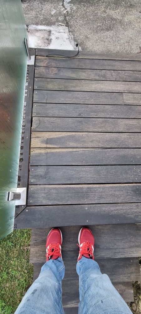

I can see the deck has a number of patches where oil is worn off, and what appears to be remnants of an earlier decking product.  I'm also not convinced this is the actual colour though this doesn't look bad at all.
I guess I'm trying to work out if I can just apply the old prouduct, pressure wash or desk scrub, or if I will also need to sand this back (there is quite a lot of deck here).

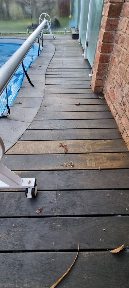

I noticed the desk scrubbing chemicals say 'poison' on them, so I'm a bit concerned about using next to the pool - any advice?

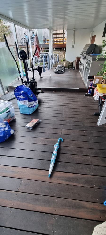

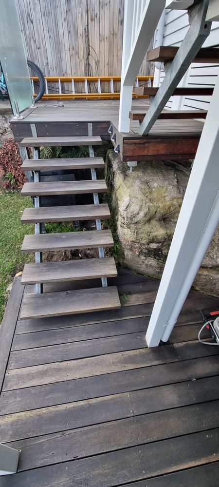

One of the decks is elevated, do I need special precautions here?

That looks to be Merbau decking.
The option is there to sand your deck back, though it looks in quite good condition apart from the watermarks seen. I'd be inclined to give it a good scrub down with Cabot's 1L Deck Clean - 1L to see how it comes up. If the staining is diminished, then you'll be right to coat the deck with new oil. Here's a helpful step-by-step guide: How to oil your deck. If the staining remains, you might like to sand the deck back to remove it.
Provided you are not flushing the deck cleaner off and into the pool, there are no concerns with using the product next to it. If there's a chance that the product could enter the pool, I'd recommend using a tarp to shield the pool during the process and work carefully around the edge. When flushing the cleaner off, direct the spray of your hose away from the pool. Also, remember to wear appropriate PPE, including a face mask, safety glasses, rubber gloves, a long-sleeved shirt, trousers and enclosed footwear.
Cleaning an elevated deck is fine, provided there is just soil under it. Once again, use a tarp to shield anything you do not wish to have covered in the product. If plants are nearby, make sure to use enough fresh water in the cleaning process to dilute and flush off the product.
The cleaning and re-oiling can certainly be done now.

I asked the old owner, and he told me that its spotted gum, and the deck oil is clear.
I've got my oxalic acid, deck brush and pressure washer, just waiting for slightly better weather then I'll go at it.
