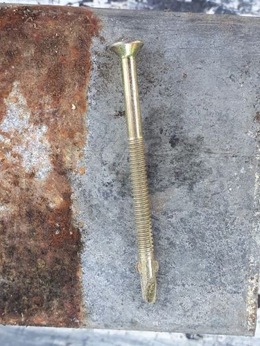

They look very similar to the Zenith 8G x 40mm Galvanised Countersunk Ribbed Head Winged Screws - 18 Pack. These are usually used for mounting timber to steel applications.
Yes they do - thanks @EricL

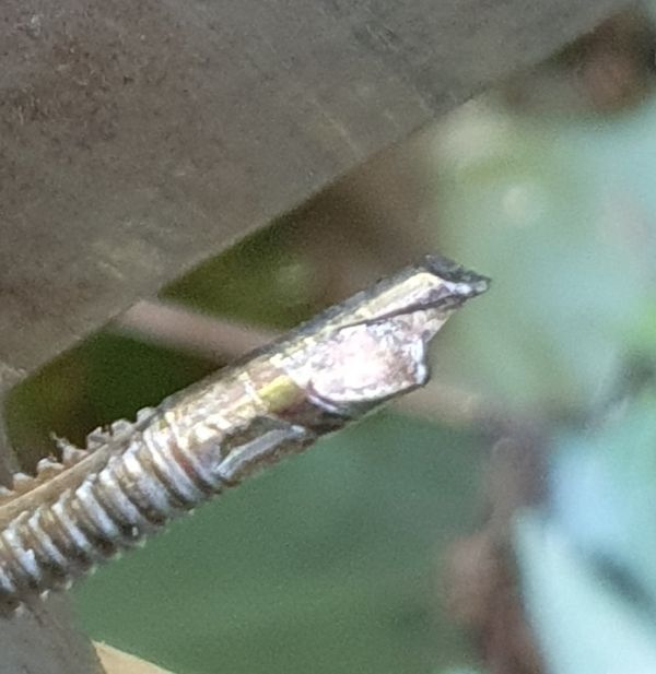

My screws are at least 40 years old - and I was wondering if age affects metallurgy?

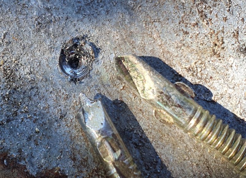

There was no way I could self-tap though 2mm steel plate - as you can see above the tip wore down to a wood twist drill profile, with no penetration.
In the end I resorted to pilot holes - the best being 3.5 mm diameter - even then, I noticed a couple of the 'armoured' cutting tips had shattered off on one side...

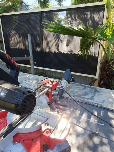

I managed to attach a 'safety' steel mesh screen to the fence, to hopefully protect my neighbour - particularly when angle grinding.
