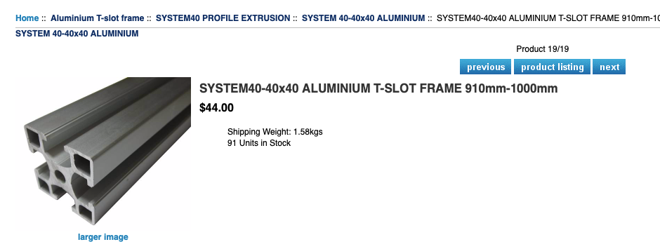

Thanks @Walter . The CNC shop looks to be the answer to the supplies query. Anyone else interested can have a look at this link which is for their 40 x 40 extrusions, 1m long:  https://www.cncshop.com.au/index.php?main_page=product_info&cPath=48_50_61&products_id=253&zenid=tud...
The headline price is $44, I haven't checked delivery costs etc, but that's not too scary.Screen Shot 2022-08-29 at 18.19.53.png
