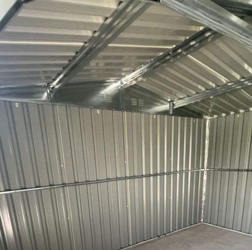

Hi all, I just built a colorbond shed 5x3.4m and it gets extremely hot inside. The walls are protected from the sun but the roof gets it directly most of the day. Just wondering what’s the best insulation to put on the inside roof? Also how do you stick it to the roof. Thank you everyone.

I trust you'll find plenty of helpful information in those discussions for your project. Foam insulation is becoming a popular choice for insulating shed roofs as it is rigid and easy to work with. It can be glued to your roof, or you can install timber batons across your beams and screw it onto those.
You might also want to also consider some ventilation for the shed, as even with insulation, the heat will still build up within it.

Unfortunately, retrofitting a shed with this product is likely not possible as it is intended to be run over the top of the roofing purlins. If you were willing and able to remove the roof sheets, you could install the ThermalLiner following the ThermalLiner™ Installation Guide and then reinstate the sheets to their original positions.
It would be much easier to use Foilboard Insulation to retrofit a shed. My colleague @MitchellMc has given some great advice and resources in How to install insulation in my Titan Shed walls and ceiling? that you could follow for this project.
