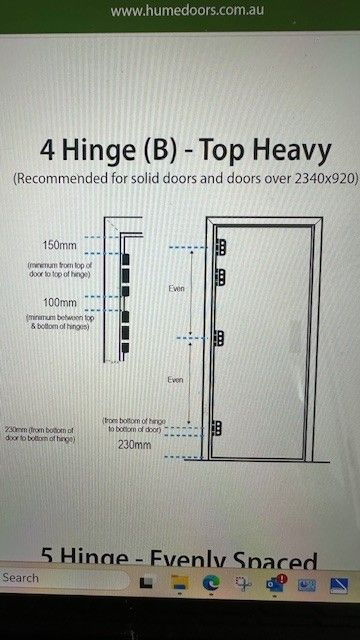

hi there i purchased from bunnings special orders 2 x external solid doors 1200mm wide x 2040 high (35mm depth) i need to know what hinges to buy and what type of screws or bolts i should use. Concern customer

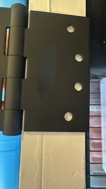

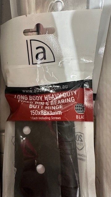

Re: 2 x external solid doors which are very heavy
In respect to the heavy duty hinges (ones above in silver) i purchased as per Hume door recommendations which i received from you,
i was in bunnings the other day and saw these ones. I wanted to know if you could touch base with Hume doors for me to see if these hinges are suitable for the 2 x heavy (extra wide) barn doors i am about to hangup. See attached photos

Re: How to hang external solid doors?
Hi @Miczam,
I am confident that these hinges when installed in the orientation I've mentioned above will be fine.
