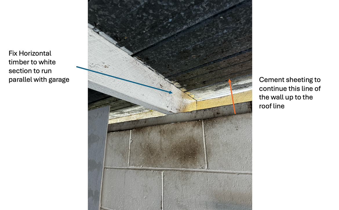

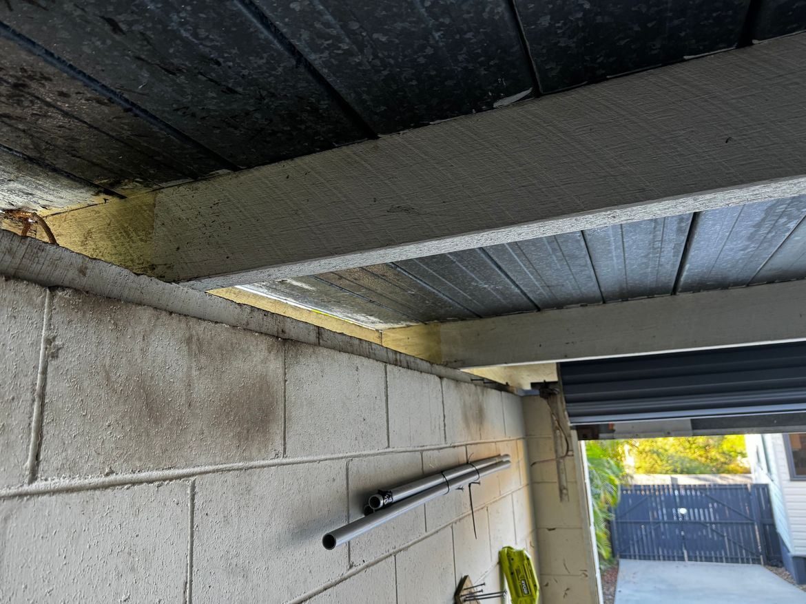

Hello,
We have a post war home, with a similar aged single garage or shed.
The construction is fairly straightforward with brick walls and a roof structure effectively placed on top of the bricks. This leaves a gap open to the elements between the top of the bricks and the bottom side of the roof.
I would like to close in this gap and reduce the amount of dirt and dust that enters into the area. I am thinking something fairly simple in which I just continue the interior wall up to the roof line using cement sheeting or something of the like? I am just wondering if this is the simplest method and/or most effective?
Photos below showing the gap between the bricks and the roof structure and my thought process for the job.
Is there a better way to do it? Any thoughts on a better solution?

I suggest having a quick look at this discussion - How to close gap between top of brick wall and carport roof? by @Jeffersm963. Your proposal of using cement sheeting is quite sound and is one of the simplest ways to cover the gap. If you want to really seal off even the small space between the cement sheet and the joist, I propose using self-expanding foam

I whipped this up today (below image) as a bit of a trial, and it's a little tight and a little ugly, but it is roughly what I think the aim was. A few things I learnt in the process, including that not much is particularly straight, my work included.
My questions would be - is there an appropriate timber in a smaller dimension given the timber to space ratio? I was using 35x70mm? specifically the 35mm aspect.
Any feedback would be greatly appreciated.

I was thinking about this awhile back, but I believe that the 70x35 would be the more robust timber size to use. This timber should be able to withstand attacks from possums, rodents and mice. It's thick enough to be drilled into without splitting and is H3 treated so will withstand outdoor exposure. Timber orientation is at your discretion, I think you've done an excellent job with that first try.
