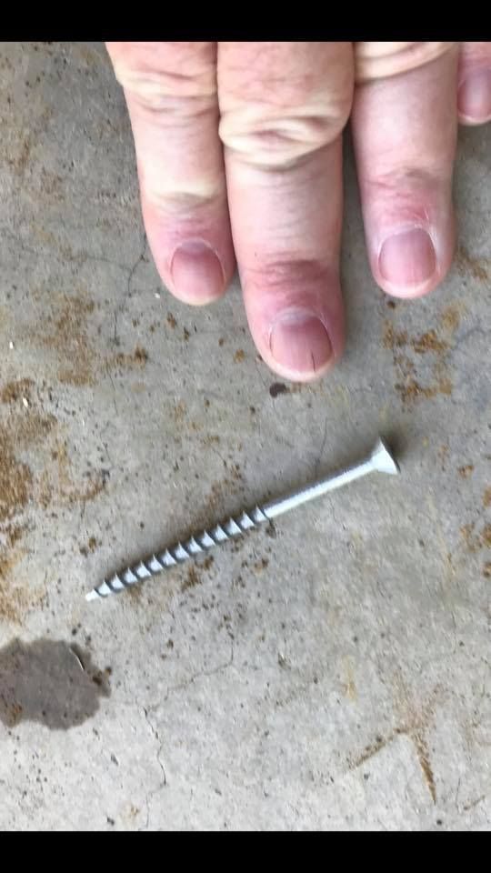

500 of External Timber Screws Countersunk 10-8*75mm

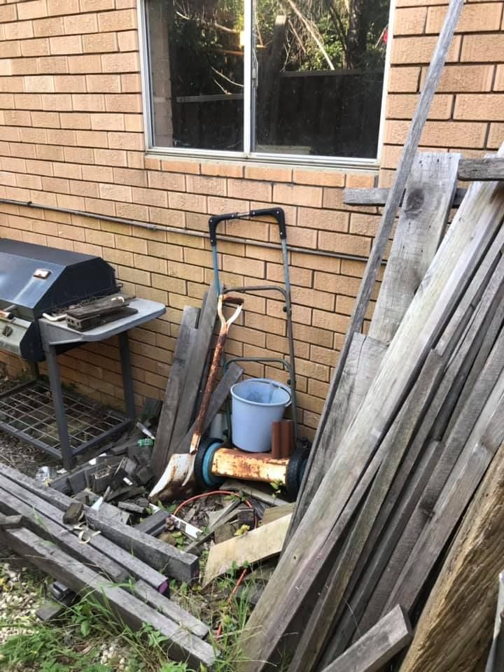

I cleaned the work area wider then I expected to use, just in case. As I was the offsider/labourer I wanted to have as much done as possible to save my carpeter mate extra time. Plus $$$ of course. This is the start of the garage retrofit to lockup/secure stage.

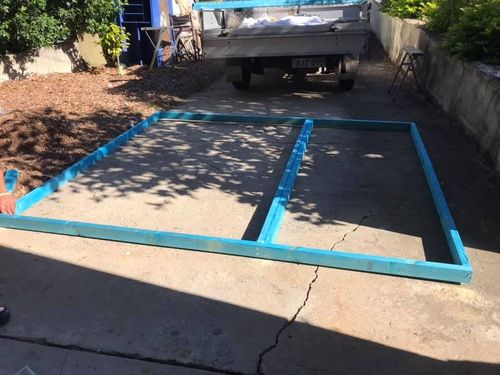

Framing with a nail gun made life a lot easier. We used the nail gun to tack the timber together and then put in two timber screws to each join.

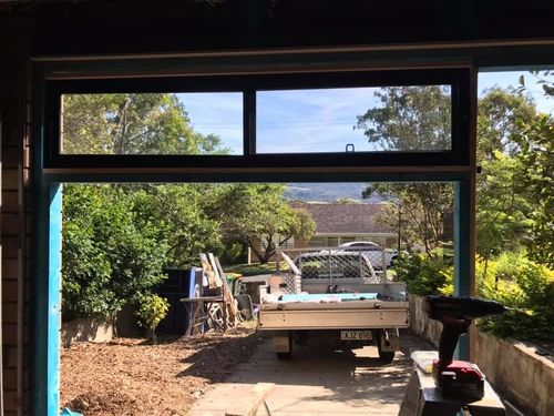

Yeah mistakes happen but can be worked around. The door frame plus the prebought upper window just would not fit. Close but no go so the solution was to use the face timber to hold the space and frame the rest.
The Sliding window in place. I was happy with the solution

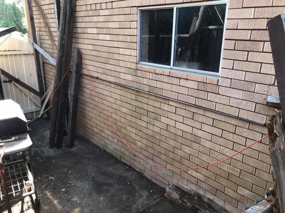

The Side door I wanted fitted into the same area as the old side window. The Lintel didnt have to be changed only two cuts down through the brickwork and across the base were needed. The gas pipe that ran along the side of the house had to be moved also. I wanted to have access to the little courtyard area as it was dead space.

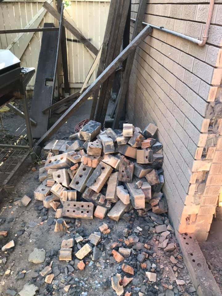

I wasnt around when the carpenter cut the brickwork... I think he figured to send me to Bunnings for something to get me out of the way :smile:
Surprising amount of rubble after the cut.

You can see the gas pipe going around the door area.

Bought a 500 box and almost went through them all for the whole garage.
Just to give an indication of the actual size I used.

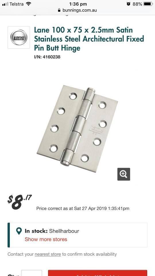

The hinges I used, two would be ok, three for sure (figured timber can warp so went with a middle one on each door.)

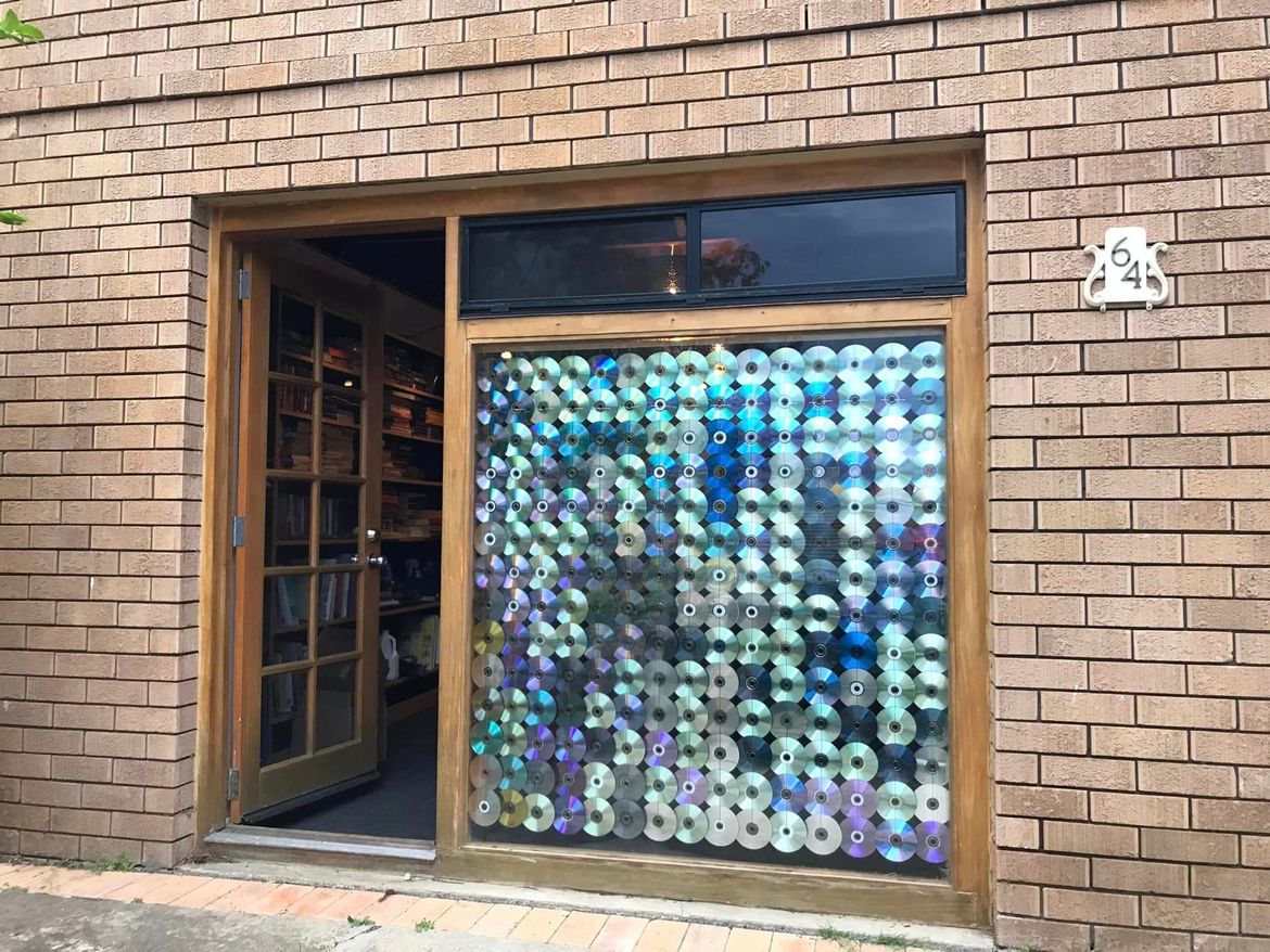

One major stuff up tho. When we were doing the sliding window on the front I was busy asking my mate questions of "How to? and should i?" type things, A storm was coming in and the daylight was fading fast  so we were working as fast as we could. The "weepage/drain" holes for the sliding windows were covered up by facing timber. This meant when it rained the water hitting the window would run down the front then backwards into the garage. We fixed it by trimming that front face (trimming it to expose the holes so the water drains away) Much laughter and cursing but still enjoyed the project.
The middle horizontal is the part that covered the weep holes. Both doors work well and there is a sloped pice to allow the water to run outside at the bottom of each door. (I have forgotten the name of it)

Thank you Eric, you are right about the sliding window but in reality I have not opened it too often! I cant take credit for the large window or the sliding window as my mate teh carpenter suggested it lol, tho I thionk it was just excess stock he had to use. It has definently worked tho) :surprised: The garage is remarkably cool in summer and warm in winter. I generally leave the door open and get a nice breeze coming in. With that large window I thought id better do something :smile: I have actually used interlinked cd's hanging of timber strips. I will see if I can post that project later today.

I have posted up a project called "Garage retrofit Privacy" that shows how I used CD/DVD's for the covering of the large window. Its not the final solution but is something I do want to incorporate into it.
