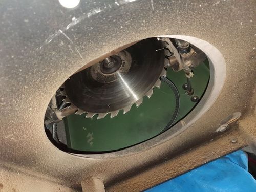

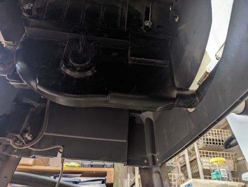

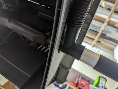

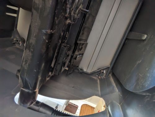

Any chance of a photo showing what's happening underneath your Ozito table saw - especially with that vacuum hose?

Sure! These show the underside and how the dust-collection port and T are all part of the single injection-molded plastic part that makes up the blade shroud;
dbaarda
Re: Dust extractor/collector for Table saw
wow... those photos are not rendering nicely in the post for me, but if you open them up you can see what they are.

All makes sense now. I was trying to figure out how it could suction near the blade. The entire blade appears to be encased in a plastic shroud with a vacuum port. What happens if there is no vacuum - does sawdust build up in the cover or does it just spit it out that port?

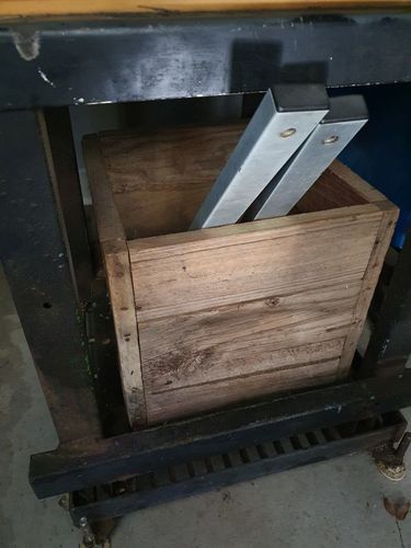

My extractor/collector is a wooden box sitting under the blade area.
Long story, but the original stand had no 'floor' as such and dust was going everywhere so I used a steel plate with a perfectly cut hole in it which once belonged to a hospital pathology centrifuge.
Works OK - mind you I only use it out in the open.

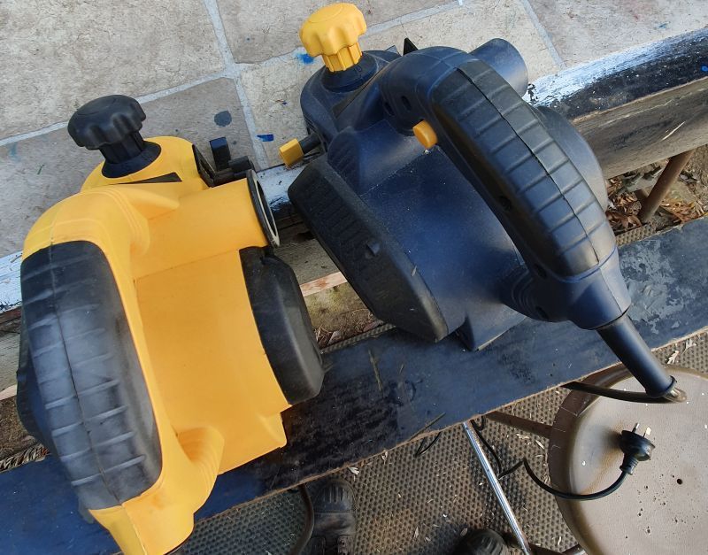

I was thinking about this yesterday cleaning out my shed. It was very common in the late 1990s and early 2000s, in chain stores like Clints, Go-Lo, BigW and Kmart - but I would have thought this would not be the case now? But what would I know.
This is a classic example - both planers from the above period. Different badges, but the only difference is the coloured plastic.

There is a kind of "flap" on the side of the plastic shroud with a bit of a gap that is held almost closed by a screw with a big silver washer. You can see it in the second and third photo. I think that without a vacuum this flap hangs open enough for most dust to exit the shroud, but with a vacuum it gets sucked closed. I haven't actually observed it in action, but I do know that without the vacuum attached I end up with a lot of dust falling straight onto the floor.
