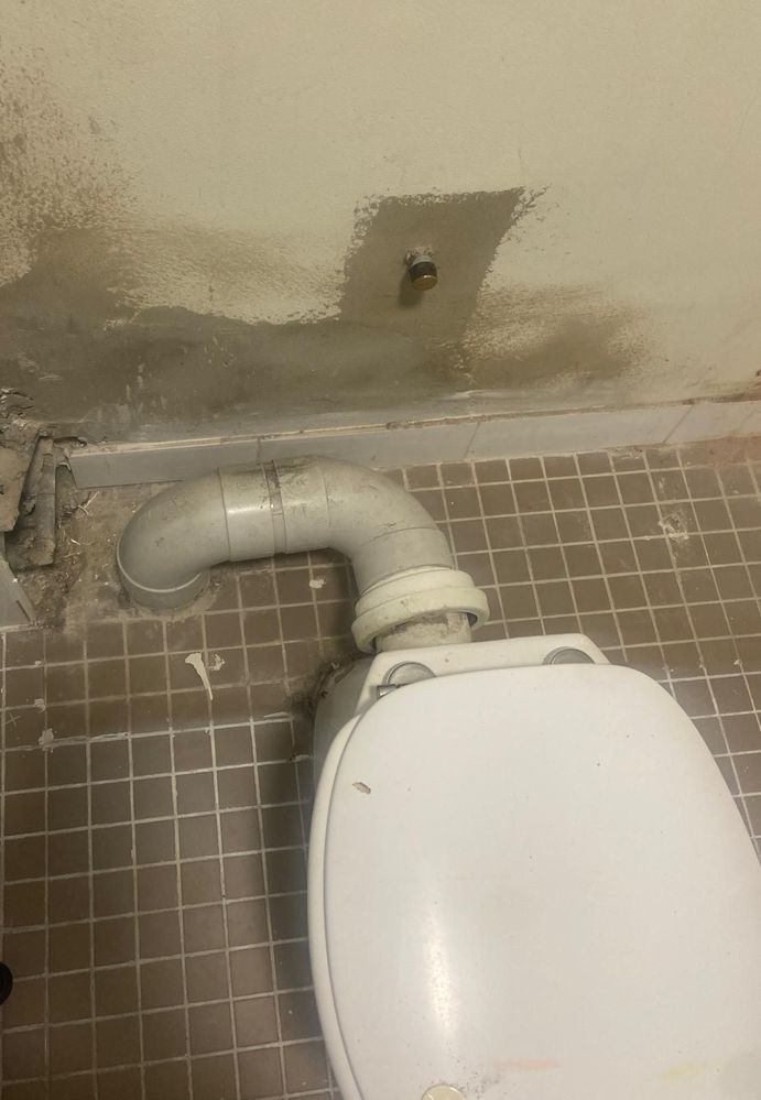

What toilet can be installed?
was hoping to get some advice. We are going to renovate our bathroom. When we took apart come of the cabinetry which concealed the cistern and piping, we got the attached. The problem is that we seem to not be able to push the toilet back to the wall due to space between the outlet and the wall. And moving it over will mean it doesnt align with the outlet.
Can you please let me know what toilet would be suitable and if anything we need to bear in mind? Prevously they had some sort of P trap converted into an S trap?

Thanks MitchellMc,
the problem in having is that the inlet will need to be higher than 430mm, and the room from the outlet on the floor to the pipes on the side wall is only 60mm, leaving very little space. Was wondering if i need to look at skew toilets to be able to put against the wall due to limited width space.its 140mm from wall to centre of waste outlet on the floor

I see @tjscott.
A skew pan is certainly an option, though you'll be left with exposed pipes, which won't look aesthetically pleasing. Timber could be used to enclose them in a boxed section.
Are you redoing your floor tiles? If so, that might be a good opportunity to have the outlet moved over a bit to accommodate a wider variety of pans.

Having a bit of a problem finding an appropriate toilet.
The issue i am having is simply the space. The bathroom previous owner had built a box, and covered the piping.
Was hoping to find a back to wall solution however, given the space between the waste outlet and the pipes next to it, it may not be able to sit over.
Is there a solution where i can have a back to wall with potentially a skew trap (while not visually great, can just build a little ledge) - or are there any other solutions?

Hi @tjscott,
It's certainly an interesting situation you are dealing with.
Have you spoken with a plumber for their opinion on the issue?
Considering a licensed plumber will have to install the toilet to ensure it is up to the relevant codes, they are likely the best person to ask this question.
You'd more than likely find that they could move the waste pipe for you to open up more options that would fit your requirements.
Allow me to tag our experienced members @Noyade and @Nailbag for their thoughts.
