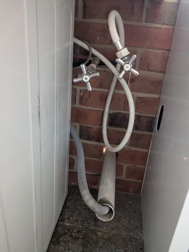

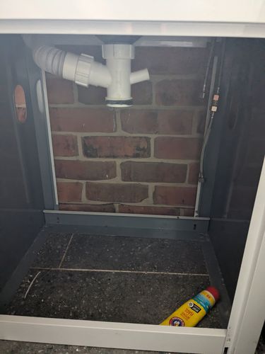

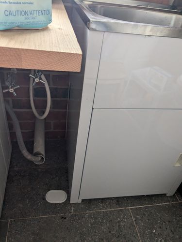

Just connecting a temporary laundry before getting something more permanent. So currently just have the old plank of wood on the washing machine next to the tub sink. Just trying to work out if I should shift the wall taps down the wall so they go directly under the sink (limits "bench" space) or to get some flexible drain piping to go out the side? Thanks!

I would say I'm looking to connect the sink temporarily. In the next 2 years, it will become a cupboard laundry and the sink will no longer be needed.
The sink being functional is more important than the bench space for sure.
I was thinking I would connect the sink to the waste and then run the washing machine waste through the hole at the top of the sink that goes through to the sink waste.

Thank you for answering those questions. Two years is a long time, and temporary connections have a habit of failing as they are temporary. I propose installing a proper laundry trap under the laundry tub and running solid PVC piping through the side of your tub. In this manner it will be compliant and sewer gasses will not escape into your laundry area.
In regards to your thoughts regarding flexible hoses, I don't recommend using them in this particular setup, it's better to use solid piping.
