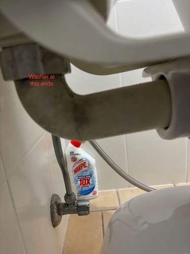

Could you please also advise how to remove the flush bottom pipe to insert new washer under cistern's Flush outlet ; I tried to push it down but found difficult and was afraid not to break anything, your expert advise would be most welcome. Thanks
Flush Pipe - How to remove the marked end to insert a washer
Re: How to replace Caroma old Fowler (square) flush outlet valve?
Hi @Kintiq
I suggest speaking to the special orders team at your local store and asking them for a quote on the spare part you need for your toilet. The reason you can't see the price for the part is because it is not a regularly stocked item. To remove the flush pipe under your cistern the big white locking ring must be turned anti clockwise first to loosen it up. Once the locking ring is loosened up, you'll be able to slide the flush pipe out.

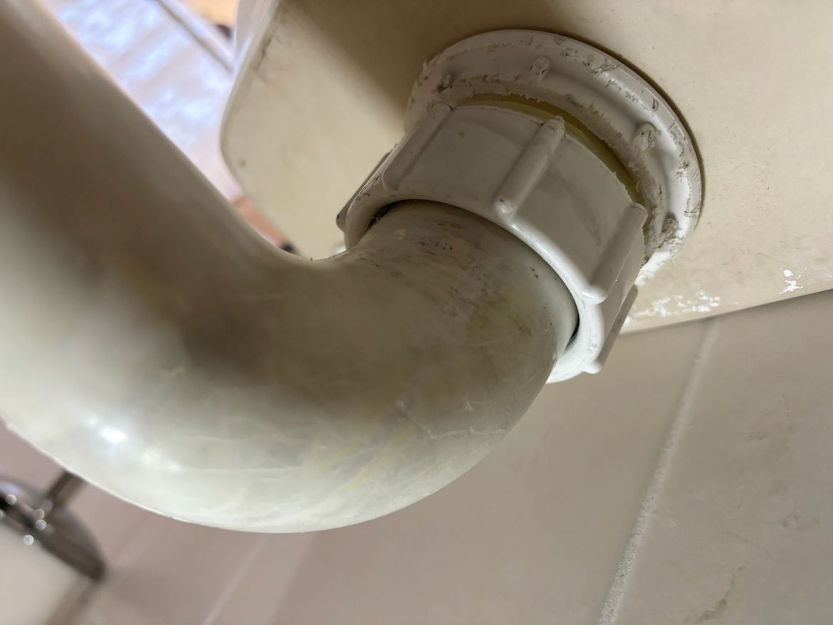

Hi All
I did it today using the new Slip Joint (SJ)
Pliers, however found the Nut is not a hexagonal see photos but round with gripping ridges.
The main problem I faced during tightening the nut , the thickness was not enough to have a full grip with the SJ Pliers, I had to struggle finally I tightened it to NO LICK position.
