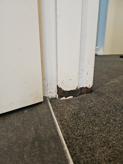

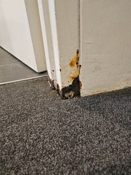

The metal door frame (brick walls) to our upstairs bathroom is rusted. I just tapped it with a hammer based on advice on a different Bunnings post and it's really rusted at the bottom. There is a large hole in the frame now.
Would this be repairable with sanding and bog or is this a replacement?
The carpet outside is not wet, and the roof storage door above it is not damaged. No other doors in the house are rusting. I am not sure if the rust was already there before the previous owners renovated the bathroom. I've attached some photos below pre- and post- hammering.

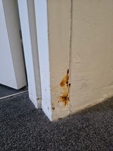

PS. The other side of the door jamb is rusting a little, but not as much as the right hand side.
Photo below shows before hammering, with visible rust spots and bubbling.

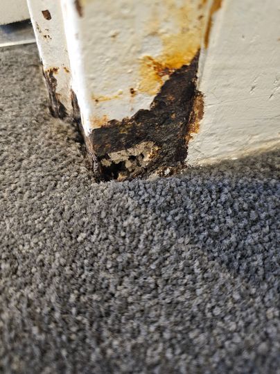

The following photos show post-hammering with the large hole.
After hammering
After hammering
Hole after hammering

I'm afraid the metal has rusted too far and can't be repaired with bog. If it was just surface rust a bit of sanding and bog would b have been the perfect repair formula, but all the support has rusted away. I propose engaging the services of a registered builder and getting a quote to replace your door frame. Once your budget is ready you can then proceed with the replacement.
