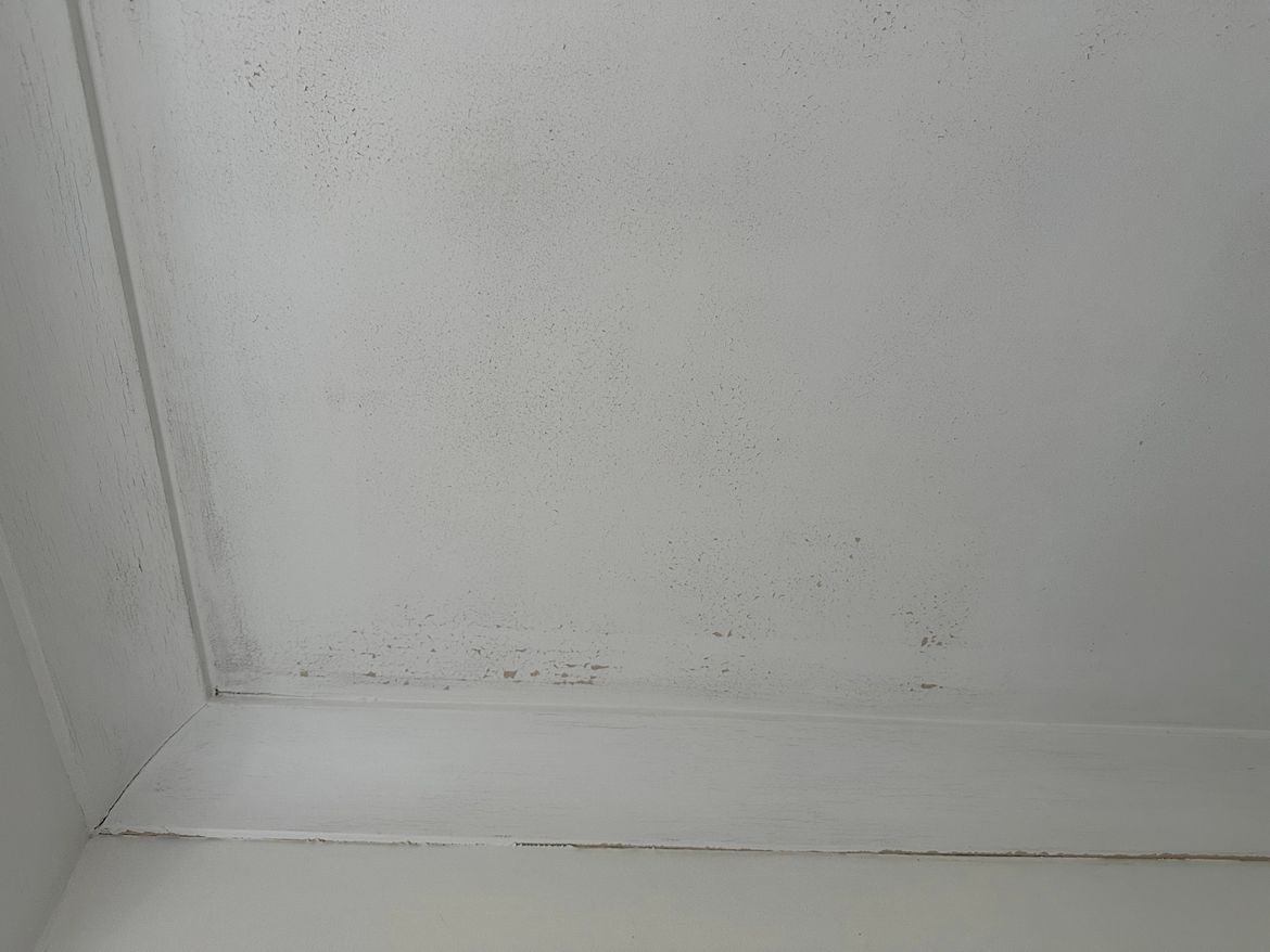

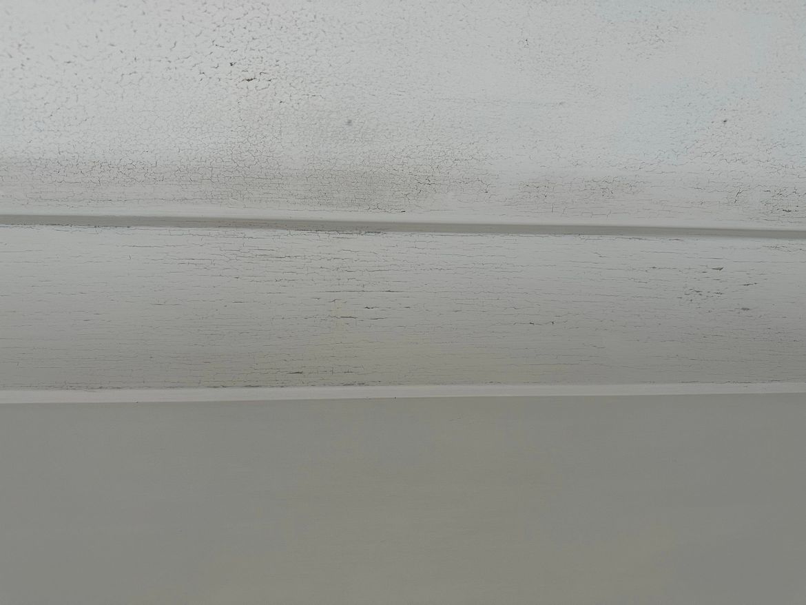

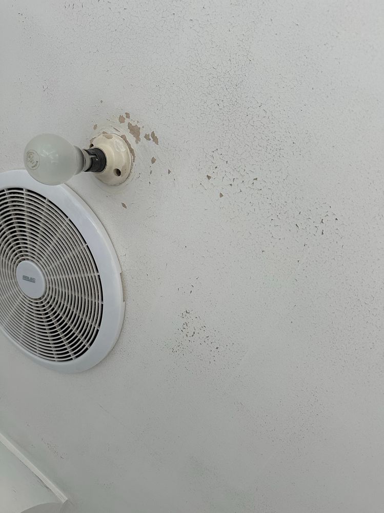

Hi there, I’m prepping our main bathroom ceiling for repainting. It has lots of cracks in existing paint, there was mould which I killed with clove oil. Cracking most likely due to oil based paint used by previous owners- it was everywhere Inc ceilings🙄
I have sanded with 80 grit on Ryobi palm sander & scraped with paint scraper. I feel that not a lot came off tho it does feel bit smooother.
will this be enough to get a good finish?

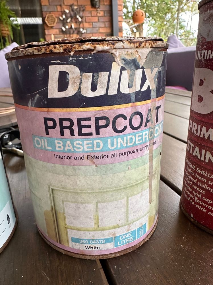

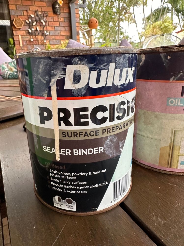

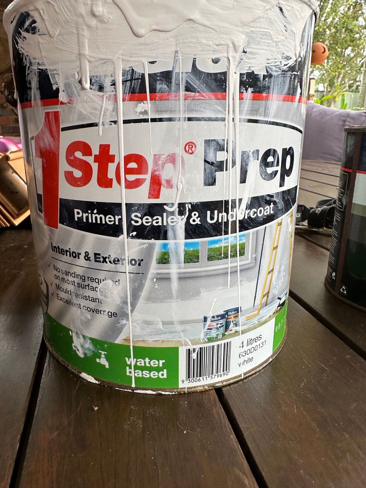

I have some sealer binder prep to use, top coats will be Dulux bathroom paint in semi gloss. Any advice Inc which sealer binder to use ? IMG_5183.jpeg IMG_5184.jpeg IMG_5185.jpeg IMG_5186.jpeg IMG_5187.jpeg IMG_5188.jpeg IMG_5189.jpeg IMG_5190.jpeg

Your prep work looks to be fairly good, however, I'd pay a bit more attention to the area around the lightbulb as this looks to have been painted with a different product that has not bonded as well as the rest of the ceiling.
The new paint is only going to be as good as the old. If the old paint underneath continues to delaminate and fail then the new coat will come off too, so taking the time to get as much of the problem areas sanded back well is going to be in your best interests.
In terms of primer, the Zinsser will be the best for this application, however, you will likely need a bit more than you have. You might like to grab a new tin of Zinsser 946ml B-I-N Primer Sealer Stain Killer specifically for this job.
Once primed, then you can apply your paint.
