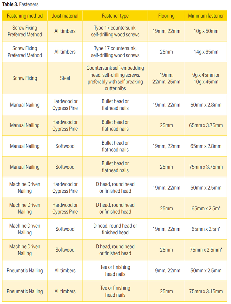

Hi @rick6947,
It sounds like you might be considering installing structural particle board flooring, which is tongue-in-groove. I've added the fixings chart below for your reference. It's preferred to screw the panels down. You can choose to use a nailer or do it by hand, but there are quite a few fixings per panel, so a drill or machine nailer would be best.
Particleboard flooring is accepted by building authorities for use beneath impervious floor surfacings in wet area rooms such as bathrooms, laundries and toilets. The waterproofing of the floor surface should comply with AS 3740, Waterproofing of Wet Areas in Residential Buildings. Bastion 15kg Under Tile Waterproofing Membrane is a suitable coating for your structural flooring and complies with that code.
If you require a gradient to a central floor drain, it can be achieved by laying a cement screed onto your suitably prepared substrate.
Both waterproofing the bathroom and adjusting the gradients of the floor are not simple D.I.Y. projects, and I'd encourage you to discuss with a builder and decide whether it's best to enlist the services of professionals for this work.

Re: How to install solid timber flooring?
If the structural flooring is the same height (19,22,25mm) as the existing boards, then I recommend you change to it. It would be far easier and faster to install @rick6947, and it would also be more suitable for complying with current building regulations.
Would screwing them down be an option @rick6947?
They require 40 fixtures per full sheet, so driving the nails by hand would be a bit of a mission. We hire framing nail guns for the day, which would be a lot easier.
Hi @rick6947,
There are different requirements for the various thicknesses of structural flooring and the type of joists you have. Details below.
