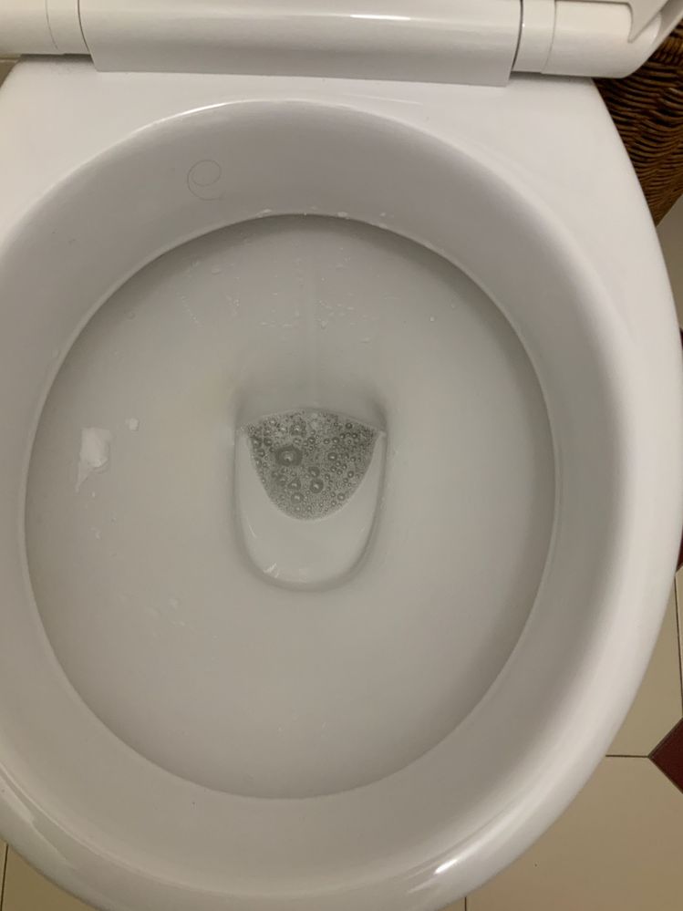

Thank you.will upload a photo of the bowl. I hope it’s clear to see the level.
Hi @DIYnewbie1111,
With a water level at the height shown in your photo, there is no way for smells to enter the room. The water is providing a seal. However, as mentioned earlier, if it's a venting issue, air bubbles could be forcing their way through the S bend and water into the room.
I'd like to hear more about "when I clean the bowl and add solution, the water level does drop until I flush it.". Whether you add water or solutions to the bowl, that should not cause the water level to drop, unless you are physically pumping the water out of the S bend through agitation with a scrubbing brush.
"I did see online ti add water after a flush to possibly help which I will try today." There is no need to add water after a flush if the water is ending up at the height shown in your image. If the water is below the line I've marked, then the airway is open in the S bend and smells can enter. If when you flush, water is not filled to above the line below, then there might be an issue with the volume of water being released when flushed.

A venting issue could be hard to detect. If it's just a few bubbles now and then, you'd only notice them as a foul odour in the room. Next time you smell it, check the bowl to ensure the water is at the level in your picture above. If it's low and under the red line, and you can see a gap, that would be something to go on. We can then try to diagnose why the water has disappeared. Perhaps it was sucked out due to a pressure difference in the rest of the building.
