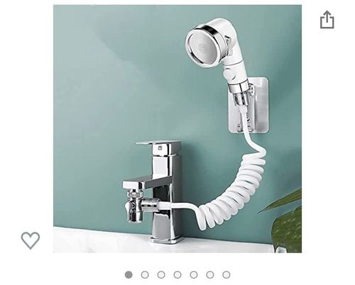

Hi all, I would like to install something similar in my bathroom sink so it is easier to shower my kid in a bath tub. This pic is from Amazon but I am unsure of the quality, would love to get the parts from Bunnings and assemble them myself but unsure where to start (what are the names of these parts)
can anyone please advise?

There are parts available in the store that will allow you to assemble something similar.
You'll need the following:
I suggest removing the aerator on your sink tap and attaching the Kinetic Adaptor Kit followed by the Flexispray Switch. You then attach the shower hose to the side outlet of the Flexispray Switch and attach the Estilo hand shower to the end of the hose. Please remember to install the O-rings provided in the kit. If you get excessive leaks check your connections and make sure that the parts are firmly attached.
Please note that If your sink tap is too low, it is not advisable to install a diverter kit as it will become impossible to use the sink tap.
