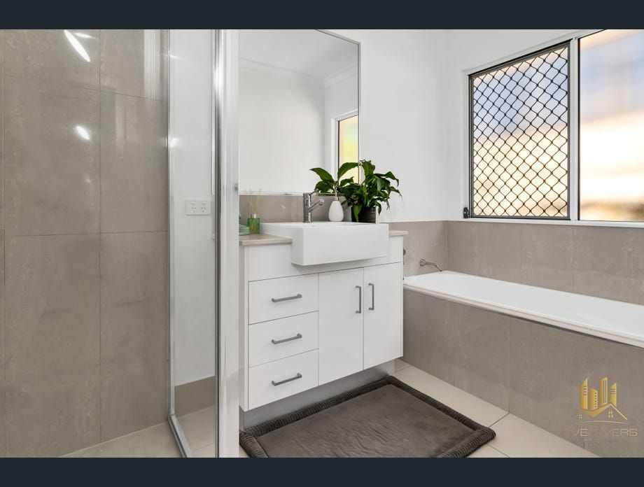

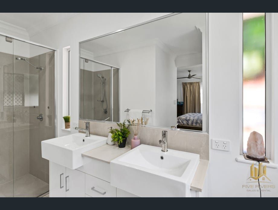

Hi, I'm moving from a great bathroom set up [open walk in shower & toilet behind vanity] to a more traditional type with enclosed glass shower. I was wondering how easy it would be to put privacy / 'frosting' effect to the shower door glass in the new bathrooms. Obviously it would be cheaper [I'd think!!] to 'frost' the glass, but if we had to replace the glass doors altogether would this cost a fortune? I live in Cairns now btw.
Thanks a lot.
