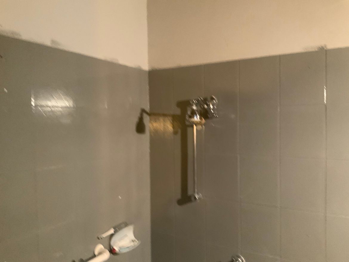

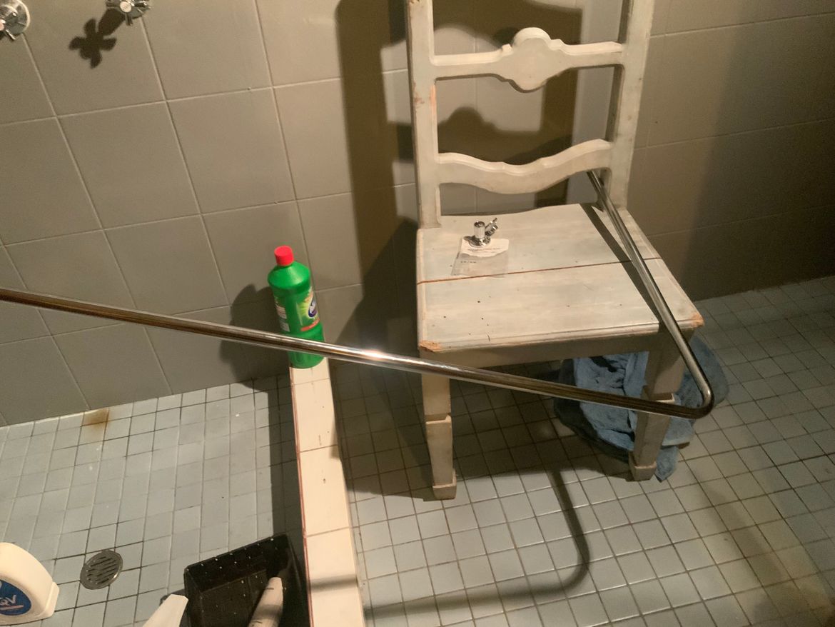

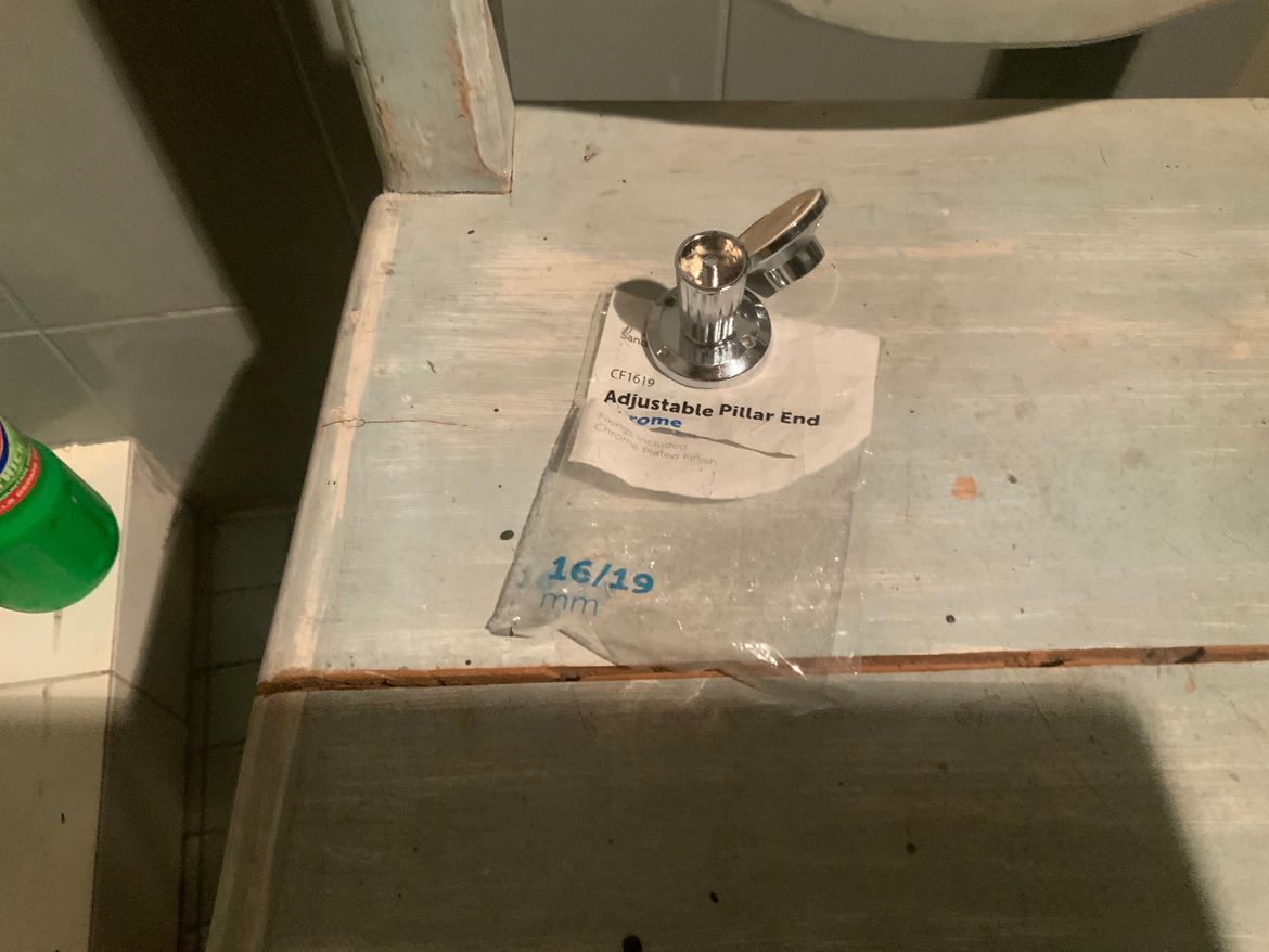

Got a sandleford  CF1619  Adjustable pillar end  l shape shower curtain rod, told  its easy ,no screws,,got home ,cannot for the life of me figure it out,it defies logic,think I’ve been robbed,,please need help!51C93438-9C34-42AC-9360-124775482449.jpeg 24E17ECD-0EA0-4594-81F4-B4E16BF6B009.jpeg 5D15E215-EE85-40F0-BBDA-236695AAFF32.jpeg

umm the  instructions from  sandleford  says as you said to adjust and tighten in place.
I am thinking that might work in between two opposite walls so a rod could press outwards towards the walls and pin it in place.
But that wont seam to work  with a 90 degree shower rod  fitting.    Fixing with screws  here seam  like the only solution strong enough  to support the  right angle shower curtain.

Source Sandleford
16/19MM CHROME ADJUSTABLE PILLAR ENDS FITTING
Sandleford's adjustable pair of pillar ends make fitting shower or curtain rods a breeze. The fitting can be adjusted to hold the rod in place by simply turning the sleeve to tighten. Each end has a cushioned backing to protect the wall. There is no need to drill holes, making them ideal for rental properties.
  • Suits 16mm and 19mm rail
  • No fixings required, just adjust to tighten in place
  • Chrome plated

It's great that you've received excellent advice from @Jewelleryrescue. I'm afraid the fittings you have are for straight wall-to-wall installation only. The Sandleford 16mm-19mm Adjustable Chrome Pillar End works by friction and compression. As you twist the adjustable end it begins to compress the pole and the ends adhere to the wall. But since you are using a Sandleford 1650 x 750mm Chrome Shower Curtain Rod you'll need to use Sandleford 19mm Modern Rod Fitting Bracket - 2 Pack along with the Sandleford 900mm Chrome Ceiling Support Rod. This is to prevent the corner of the shower curtain rod from tipping out.
I'm sorry that there was a miscommunication regarding the installation parts for your shower curtain rod. Unfortunately, there are no compression fittings for a 90-degree shower curtain rod. I'm afraid it will be necessary to drill into your walls and ceiling if you wish to install this type of rod. I don't wish to overwhelm you with information, please let me know if you can drill into your walls and ceiling and I'll provide you with more advice on what you need to use.
