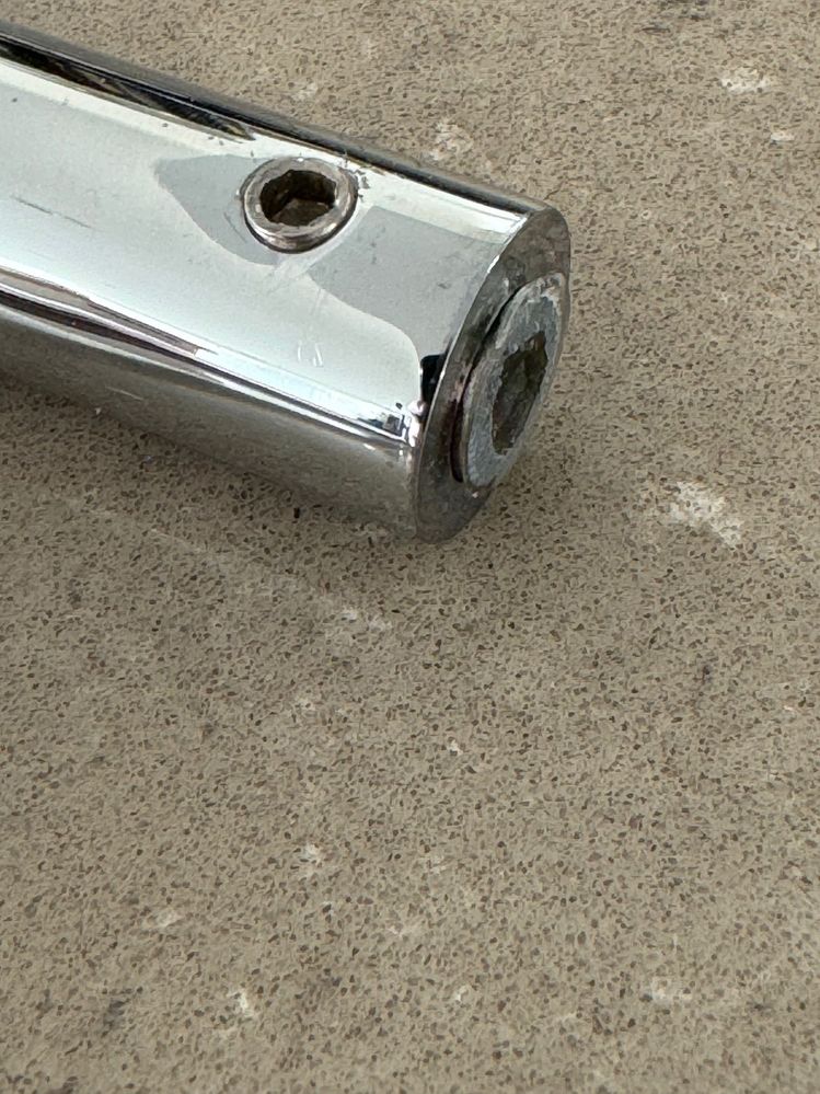

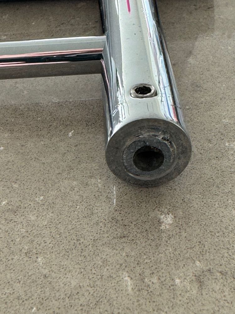

Hi all,
My wall mount of towel rail is broken. Any glue recommendation for a metal to metal glue to fix this?
Thanks
Ben

It all depends on how much you love this towel rail. If no love - then maybe as suggested by those above - buy a new one. If on the other hand is it sentimental and you don't want to re-drill new holes, then I think it's worth attempting to repair this mount and/or make a new one.
I think it would be fairly easy to weld that lug from the back, especially as my eyes see an indentation at the back of the bracket - provided this is a steel product.
But looking closer at your photo - is it fractured die-cast aluminum alloy of sorts?
What is the diameter as indicated? If easily sourced we can make this rod whatever length you want.
See what you think, and share us your thoughts.

Hi Noyade,
The diameter is 8mm. I would definitely like to keep the towel rail if possible. I am not certain whether it is a steel product but don’t think it is aluminum.
Anyway, I want to repair it if possible. What is my next step?

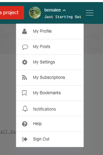

Hi @bernalee,
See the below images showing you how to send a private message.
Step 1 - Click the arrow next to your username and then click "private messages".
Step 2 - Click the red button that is circled above.
Step 3 - Type in the user you wish to send a private message to, then write your message and hit send.
Hopefully this will help, if not let me know, I can assist further.

I can't find private message from my options.
Best
Re: Metal to metal glue
Hello @bernalee
I've updated your account, please give it about 20 minutes and check if the private messaging has appeared on your options.
