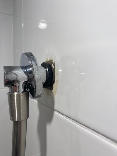

Apologies for my seriously late reply!! Life got in the way but finally come back to it. Definitely no grub screw but I did remove the caulking and this is what it looks like. Should the chrome head screw off?? Or is it attached to the brass piece? I’m still having no luck trying to screw it off

The tap will be tightly threaded onto a brass fitting, so rotating the tap head anticlockwise is going to be the way to remove the tap.
I'd suggest grabbing some multigrip pliers, covering the grooves in two or three layers of masking tape to protect the chrome of the tap stem, gripping it as tight as possible and turning it anticlockwise.
There may be buildup in the threads that is preventing rotation, soaking the connection in WD-40 and allowing it to penetrate the threads for around 5 minutes may help to clear some of this buildup.
Percussive force may also help to loosen things up a bit. Use the same tape on the head of a hammer and lightly hit the tap stem while rotating with your pliers. The combination of rotation and percussive forces may help to loosen the tap and allow for removal.
If you try all of these steps and still have no luck, I'd suggest contacting as plumber to assist.
