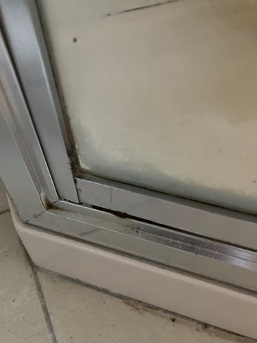

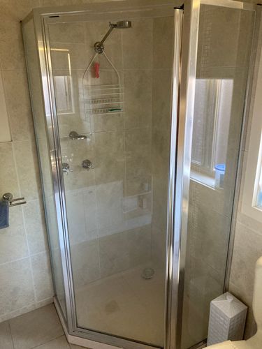

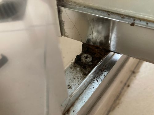

Hi, we've been having an issue with the door of our shower catching and having trouble closing. It has been an issue ever since we moved here a couple of years ago. I have attached photos, you can see the aluminium at the bottom of the door has started burring the frame. Up until now we've either pulled it really hard to close or have physically lifted the door at the handle to stop it catching, but as of late it seems to have gotten worse with my wife now stating she can't properly close the door at all.

Shower door
Door can't close

Burring of door at bottom hinge

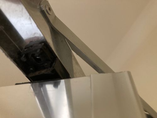

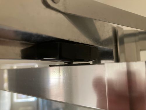

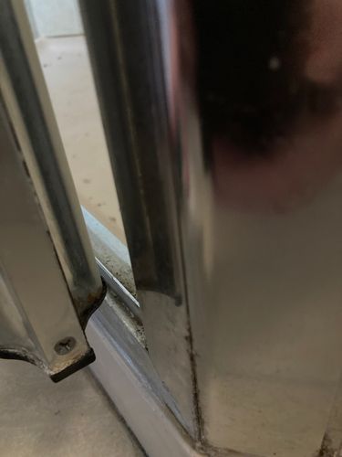

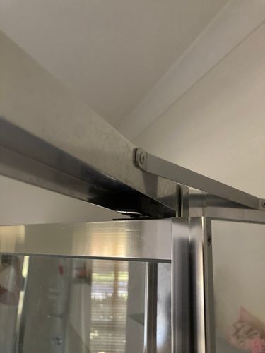

I followed your instructions to get more photos and believe I may have fixed the problem. I have included photos anyway and an explanation in case there's anything else I might have missed.
I looked at the hinges and noticed they were covered in plastic caps I managed to remove the ones from the top hinge which exposed screws which were holding the door hinge in place, when I started to unscrew one of them the door started leaning even further so I loosened both top screws and gave it a good hard push back the other way then re-screwed both back in - this appears to have fixed the problem as the door has stopped catching (just barely - I think the shower frame itself is not fully straight as there's now more gap at the top than the bottom now, but regardless it now closes properly).

Top hinge
Top hinge with plastic cap removed
Bottom hinge with plastic cap removed
Screw removed from top hinge
