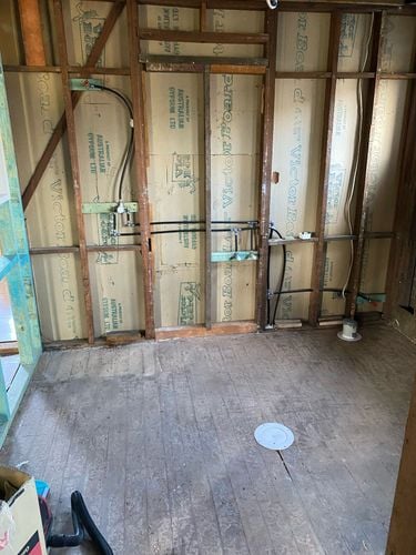

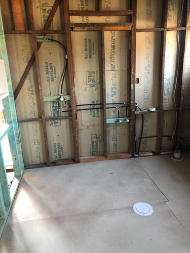

We are renovating an old bathroom, which had had timber floors. I’ve layed Hardie ceramic tile underlay on top (ctu) of timber floors.
What’s confusing is how to get a fall as it’s pretty much flat at the moment.
do we need to screed it to get that fall?

Yes, you’ll need to create a fall for proper drainage, especially around the shower area. A self-levelling compound won’t help here because it’s designed to level surfaces rather than create a slope. Instead, a screed is typically used to achieve the necessary fall.
To do this, you’d apply a sand-and-cement screed mix over the Hardie underlay, shaping it to direct water towards the drain. The fall requirement varies depending on your drainage setup and possibly the rules and regulations of your local council.
If you are applying a fall for the entire flooring area, I suggest leaving it to the professionals as they will have knowledge and experience to apply the screed properly. I don't recommend doing this as a first time D.I.Y project as any inconsistencies in the application of the screed could cause water to pool on the surface of your bathroom floor.
