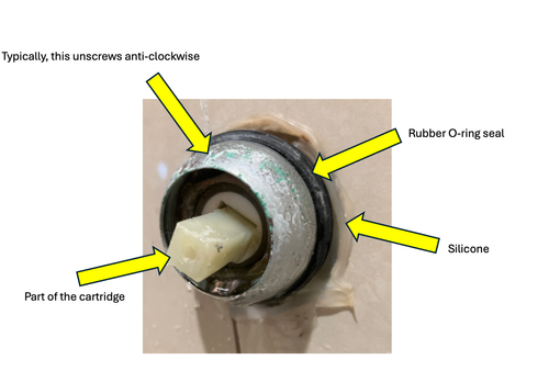

In the process of removing the cartridge, I am having difficulty removing the ring encompassing the cartridge.
Please find the photo attached.
On the photo, there appears to be a white and cloudy material (wax or hot glue gun, not sure) surrounding or sealing the ring.
What should I do to remove the cartridge that is stuck within these rings?
I would appreciate your support.
ring surrounding faucet
white wax or material around the ring

The white cloudy material is actually silicone which is often used to seal the gap between the shower mixer and the shower wall. this prevents water from entering the gap. There are two possible options with the cover ring, you can either try to turn it anticlockwise or pull down as it might be clipped on.
The black ring appears to be some form of holder and is somehow linked to the cover ring. You can also try to turn the black ring perhaps its this one that's holding the ring in place. If it proves to be difficult, I suggest engaging the services of a plumber to disassemble your shower mixer.

The image below is the breakdown of what were are seeing here.
1. The silicone prevents water entering behind the tap fitting into the wall and has no bearing on the ability to remove the chrome cover.
2. The rubber o-ring in this situation does very little other than provide a soft barrier to the mixer handle during operation.
3. The centre square stalk is part of the cartridge which would be gripped to remove the cartridge once the outer chrome ring is removed.
4. This outer chrome ring is very corroded and needs to unscrewed anti-clockwise to be removed to allow the cartridge to pull out. It will need a pair of multi-grips or a plumbers pipe wrench to remove it but at the risk of damage. Most likely cosmetic only.
My advice is to get a plumber in to remove it and source one of the countless cartridge designs through the trade plumbing suppliers if not Bunnings themselves. the plumber will have the wrench required to remove the ring hopefully without damage.
