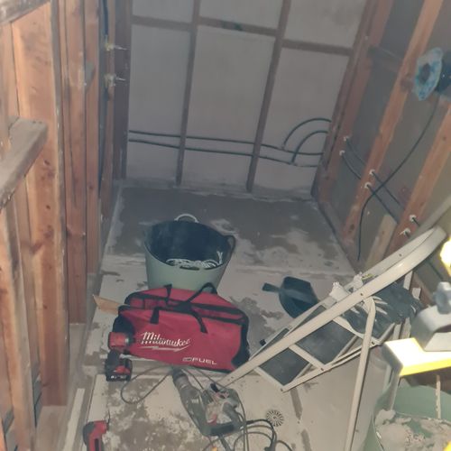

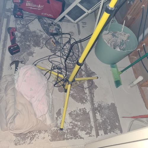

Currently doing a bathroom reno. Just finished ripping up the old floor tiles in both the shower area and main bathroom area and found shower floor consisted of 16mm fibre cement sheeting, waterproof membrane, cement screed, thin tile set and then tiles. The main bathroom area consisted of yellow tongue flooring, waterproofing, thick screed, thin tile set and then tiles.
 After ripping it up, the old water proof membrane is obviously torn, damaged and patchy due to my handy work.
Question1. Can I install floor leveller ontop of the old thin, damaged waterproof membrane in main bathroom area, then add tile underlay and then waterproof or do I need to remove ALL of the old membrane before the leveller.
Question2. What is the easiest way to remove old waterproof membrane if needed.
Thanx in advance.

Unfortunately, it's not advisable to use a self-levelling compound over an old waterproofing membrane as it will struggle to bond to the surface beneath.
It would be much easier to attach the tile underlay first and then apply a self-levelling compound over the tile underlay. You can then waterproof over the self-levelling compound and tile over the top.

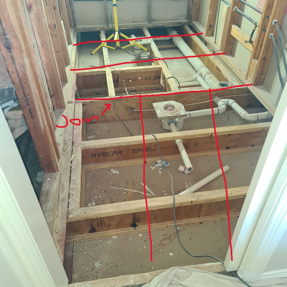

Thanx for your reply Jacob. I have decided to remove the floor completely and replace it with James Hardie 22mm Scyon Secura sheets. As far as Im aware, the sheets need to be installed opposite direction to the floor joists, however, half of the bathroom the floor joists are running vertical and the other half of the bathroom floor has them running horizontal.
My question is, Am i ok to trim the sheets on the long side and join the long side and the short sides when the floor joist direction changes in the center of the bathroom ?20240717_1359302.jpg

The short answer is yes, you can do that. However, either way, whether you were to install new joists and continue running the sheets in the same direction or switch them to continue the perpendicular installation requirements, you're creating the need for a control joint there.
Unlike the tongue joints, the joint could experience flexing regardless of the supporting joist underneath. You'd need to have a control joint in your self-levelling and then one in your tiles. You need this joint to ensure the tiles and/or grouting above the joint doesn't crack.
