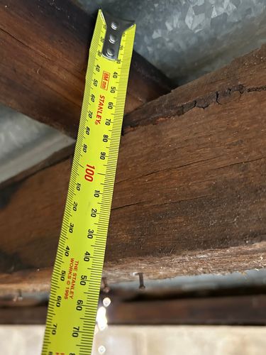

Hi Very very best, regardless of cost to insulate a skillion roof. Measurements in photos. Is the top timber beam enough for the air gap? I’ve looked at space blankets that don’t look very well made and thermal- liner & break. Not sure if the break is worth extra for a timber house roof. ? Also besides this product being stronger does it actually reflect more sun than plain staking?
Also will 90ml batts fit correctly? Thanks (getting a new roof)

Any air gap is better than none at all. Typically, insulation batts offer the best thermal insulation out of the available options, and you'd only not use them if you didn't have the space to fit them. In your 90mm of height, you can easily fit 90mm thick insulation batts, which will generally give you an R2.5 rating.
