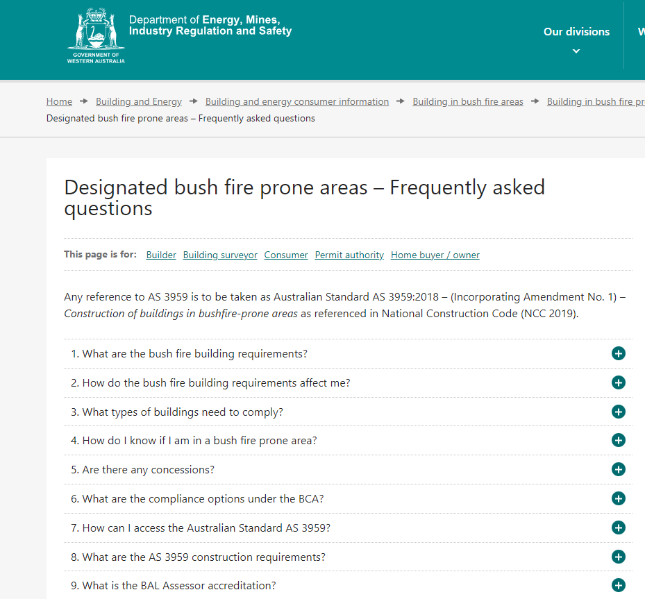

Re: BAL Assessments and retrofitting bushfire construction
If you google BAL Assessment WA you will find people that can help you get an assessment, or The Department of Commerce have questions and answers about BAL Assessments.

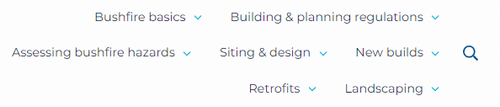

Re: Who to contact for BAL Assessments and retrofitting bushfire construction?
Hi I have found a great little Blog on Bushfire Retrofitting for existing structures:
Retrofit for Bushfires
Seems pretty simple, there are a few Bunnings mentions in there as well as some of this gear you can buy to assist.
Here is a second one i have found as well, its from CSIRO:
Bushfire Best Practice CSIRO
Few great pages within:
