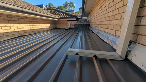

hi all

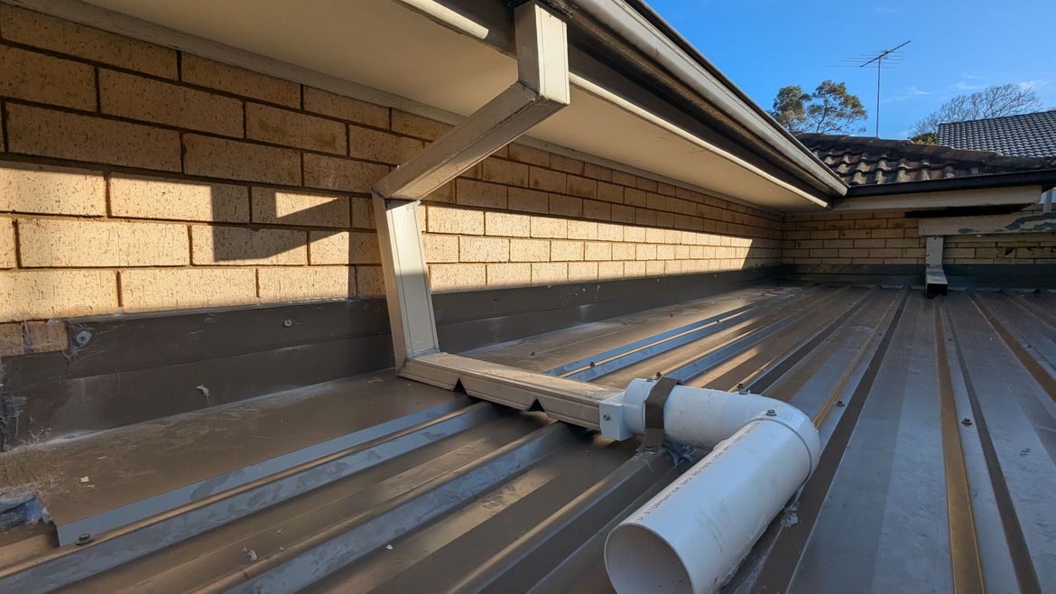

I got a roofer to fix my garage roof and i am not sure if he did everything he meant to.
In the quote it says
"Removal of all sheeting and flashings" and "Supply and install custom flashings"
I attach the photo of the finished work.
From what I research the flashing includes the part which is fixed into the brick to lead the water to the sheets and I circled around it in the photo. But the roofer has not changed it and claims this is not the flashing he meant and this part is not included in the quote.
Could someone please let me know if i am wrong here?

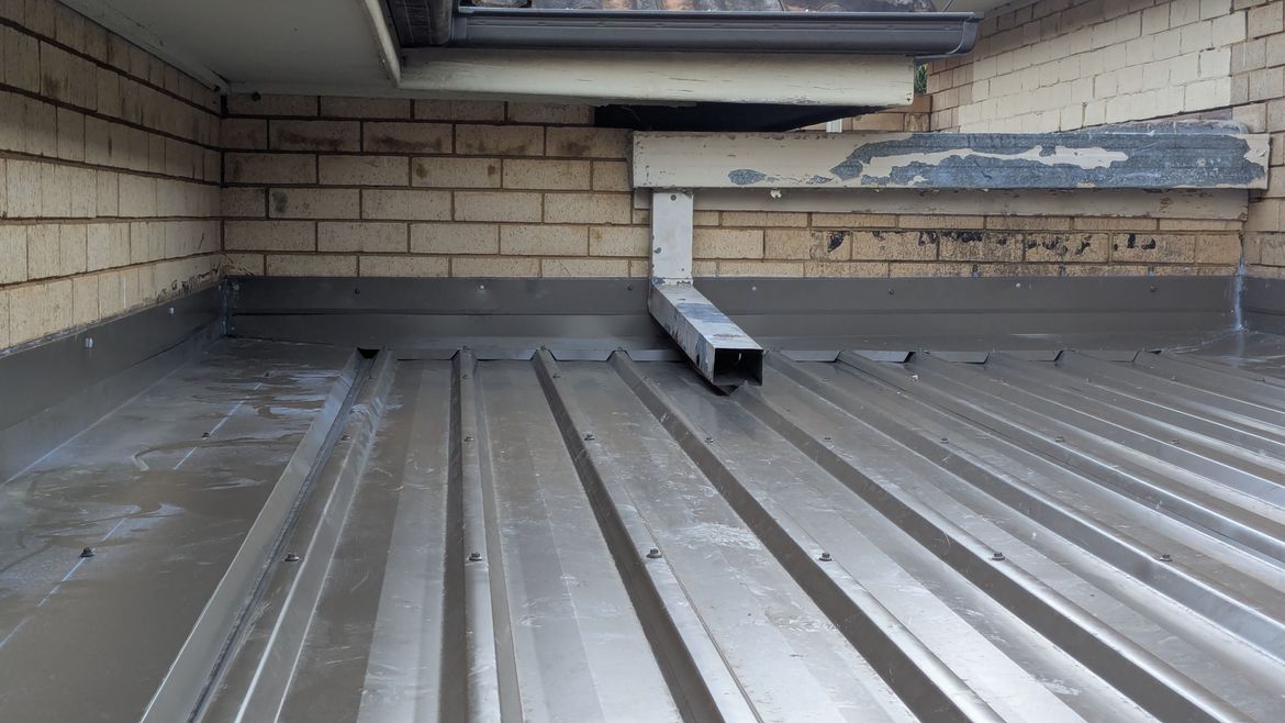

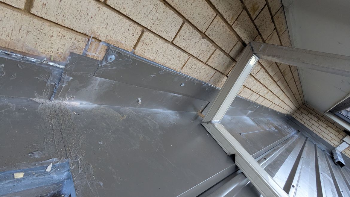

Update: The roof continued with leaks and after fighting with the roofer for months and multiple failed attempts by him for the fix, he came to install new flashings.

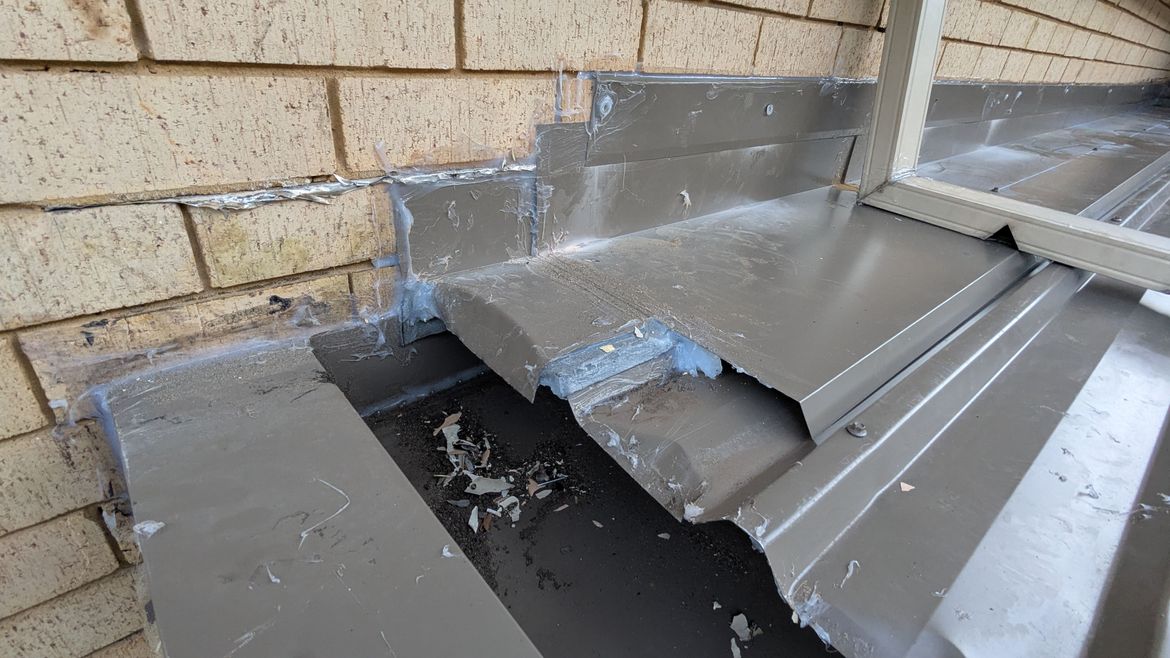

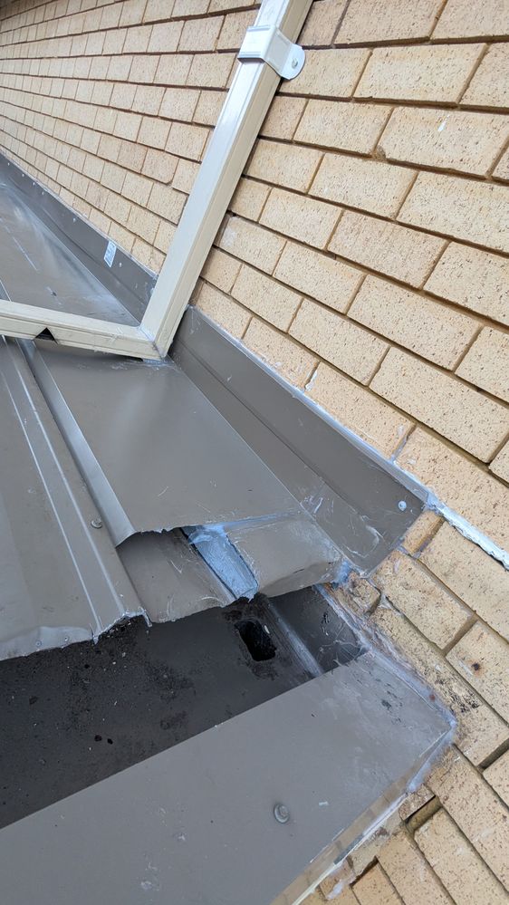

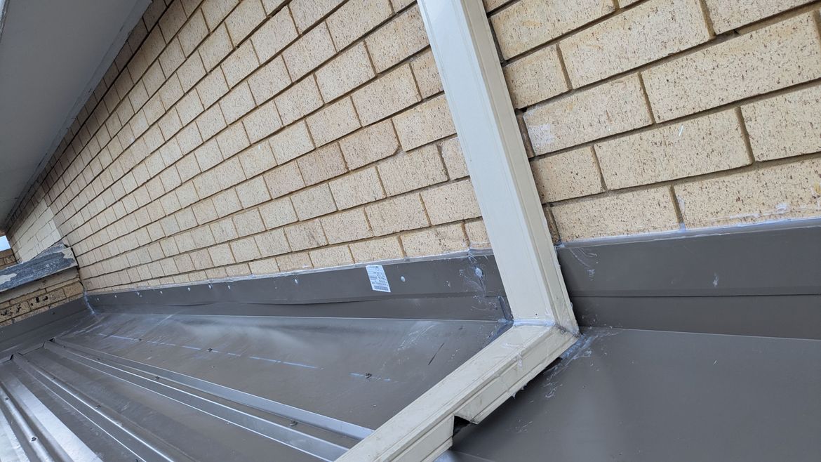

Seeing the final work, I noticed below items which I appreciate your input:

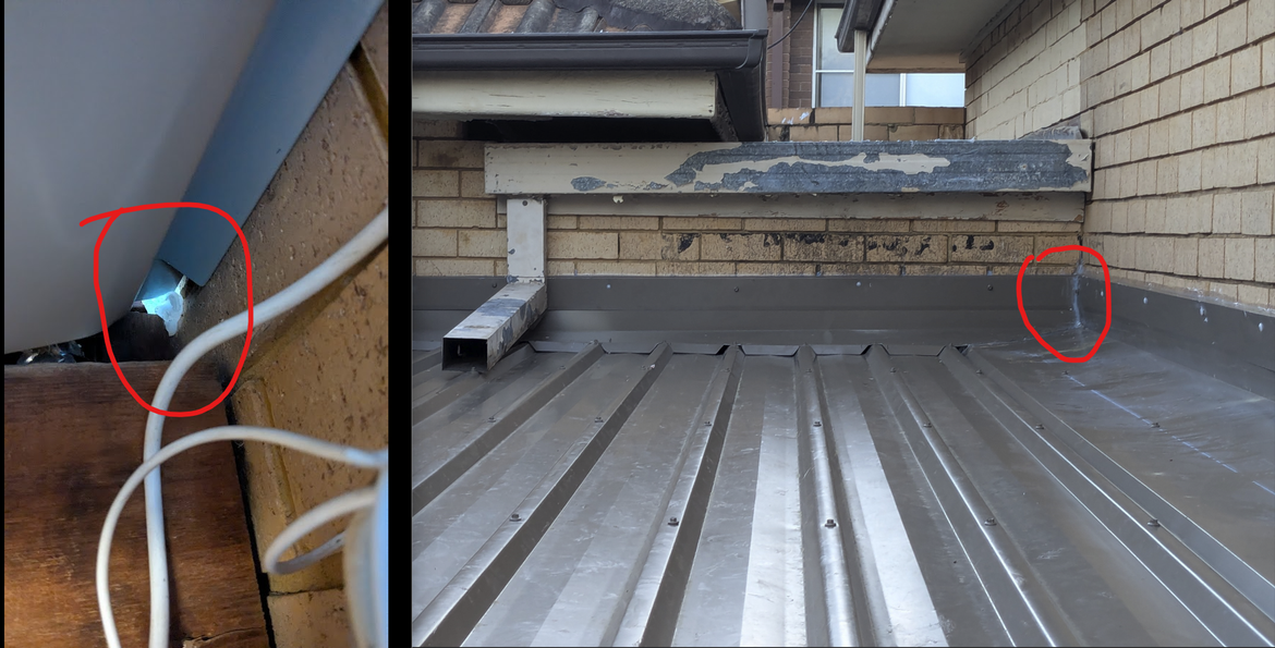

  • Isn't the flashing meant to continue all the way and pass the gutter box (similar to the old flashing)?
    • The left and the right side are following a different method as I marked. Are they following the standards?

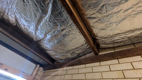

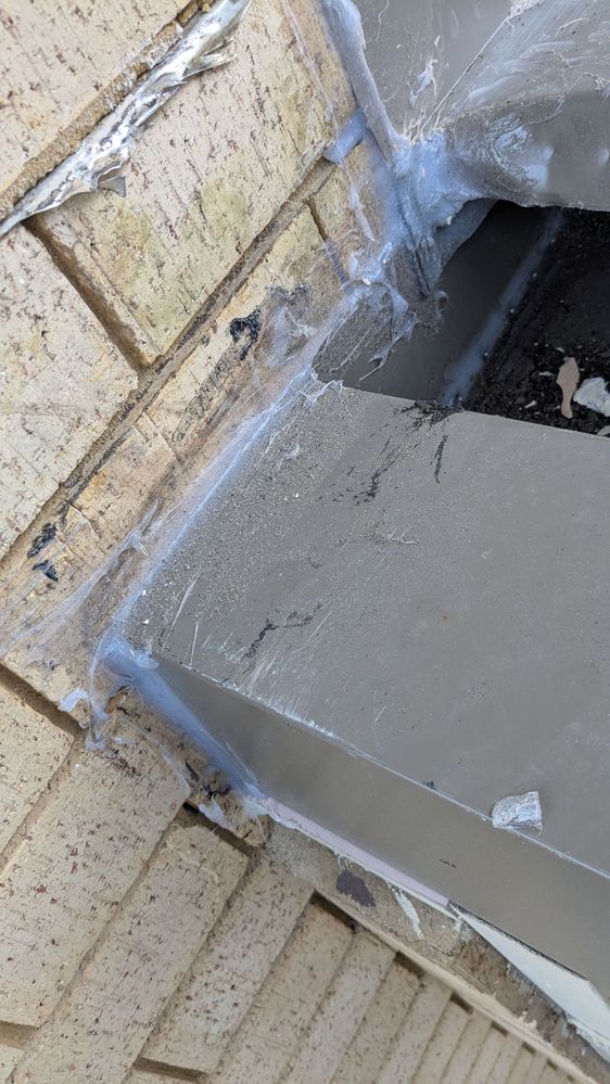

  • I see this big hole (size of a $1 coin) from the inside which is filled with silicon from the outside, isn't it concerning?.
  • Generally speaking, are there too much silicon and a messy final work or this is normal?
  • Isn't the final work relying too much on silicon; rather than overlapping the sheets and flashings?

In regards to repairs made to your roof, I was wondering the same thing about the flashing and why it was cut in that particular fashion. I suspect that the roof installer must have been following standards as well, they must have had a reason to do it in this particular fashion. The excessive use of silicone is a bit of a worry; I get the feeling that they are compensating for the lack flashing and have decided to use silicone to solve that shortfall. But then again perhaps they are just overprotecting the edges to prevent any possible leaks.

Its a hard call about why they have done the cutting/stepping of the flashing. I suspect there is a reason, maybe so the flashing cannot be seen from the ground? But something logical as I think it would require extra work to shape it like so.
Excess silastic... Its not the greatest job I admit. However maybe they went hard on it to reduce to chance of leaking. If there has been back and fourth discussion maybe they just want to make sure its done so used more then needed?
The 1 dollar sized hole in the corner. Mmm  Another more silastic is better for a suspect leak point?
The last question I have, How much of the bad silastic-ing can be seen from the ground?

I suspect the reason is as simple as being short on their measurements, seeing their history of work. The old flashing was coming all the way and passing the gutter box.
Im just worried that instead of flashing being the cover, now there is only silicon as the barrier. And that was one of  the point where there used to be a leak.
-Yes there has been many attempts but not the right fix, fingers crossed for this time.
- not sure what is the 2nd question. I need to test and run water to see if it passes, which believe it will leak
-nothing is visible from the ground.
