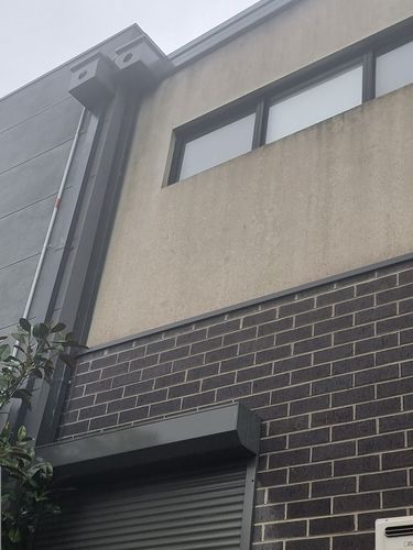

Last year, I moved into a 10yo double story house. Recently, when it has rained, I've noticed water leaking into the bottom level of the house. A thermal camera has shown water is leaking through the aluminum strip, which sits flat on the bricks and separates the brickwork and the render on the first and second story. It has been siliconed so water does not enter the house above the aluminum strip, however the silicone has started to fail letting water enter the house. Is it worth re-silicone the gap between the aluminum strip and the house, or replace with a more permanent solution? Any recommendations? Thanks.

It sounds like siliconing the gap is not a permanent solution. If the silicone has lasted ten years, then reapplying it could give you another ten. It would be best to remove the current silicone and use Sikaflex 11FC instead, which is a polyurethane sealant of superior quality to silicone. As a secondary measure, I'd recommend that flashing be placed over the joint. The flashing should start on the wall above and then transfer out onto the aluminium strip. This should help water running down the wall travel off and over the aluminium instead of pooling on the joint.
Given the height, it would be best to have a professional complete this work.
