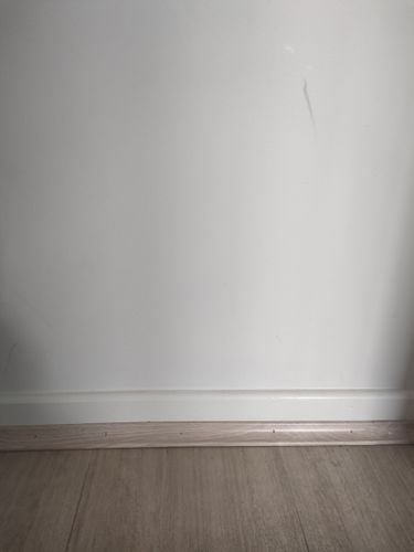

I am a mum of two boys and new to DIY Bunnings. Need some advice please:
How would I know if my doors are already painted with oil, water or semi oil paint as I need to strip off the old paint?
And also shall I re paint doors as well for an 11 year old house or just the walls would be enough? My friend said once you paint walls U might think about doors - but I am confused as it is a big task for a beginner.

Before starting work on the walls, check out our guide How to paint like a professional by experienced member @Peggers. I note that the wall in your photo has a mark. This might be able to be removed with some sugar soap or a magic eraser. The Bunnings guide How to clean your walls might be helpful.
