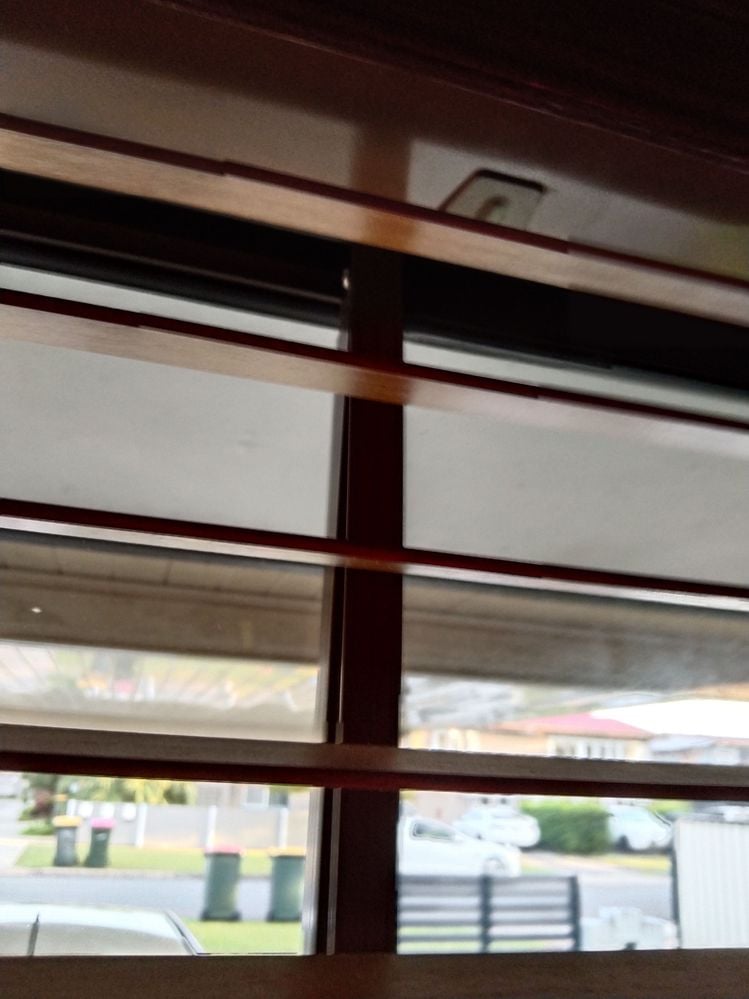

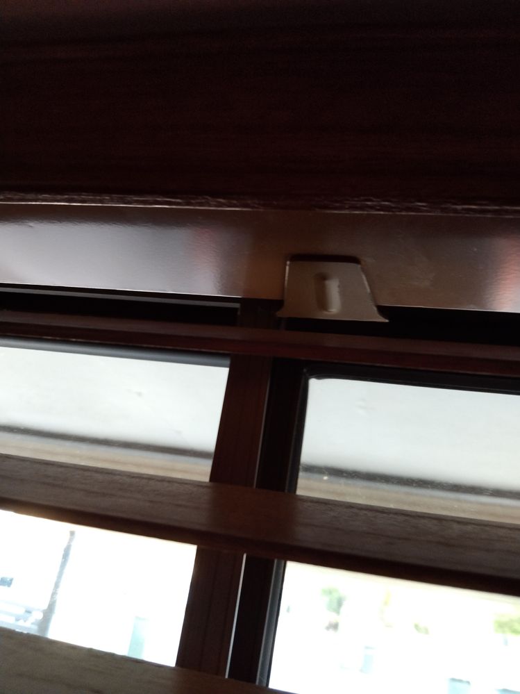

There are 2 aluminium windows I can't open at all, and one front loungeroom window which can't be closed!

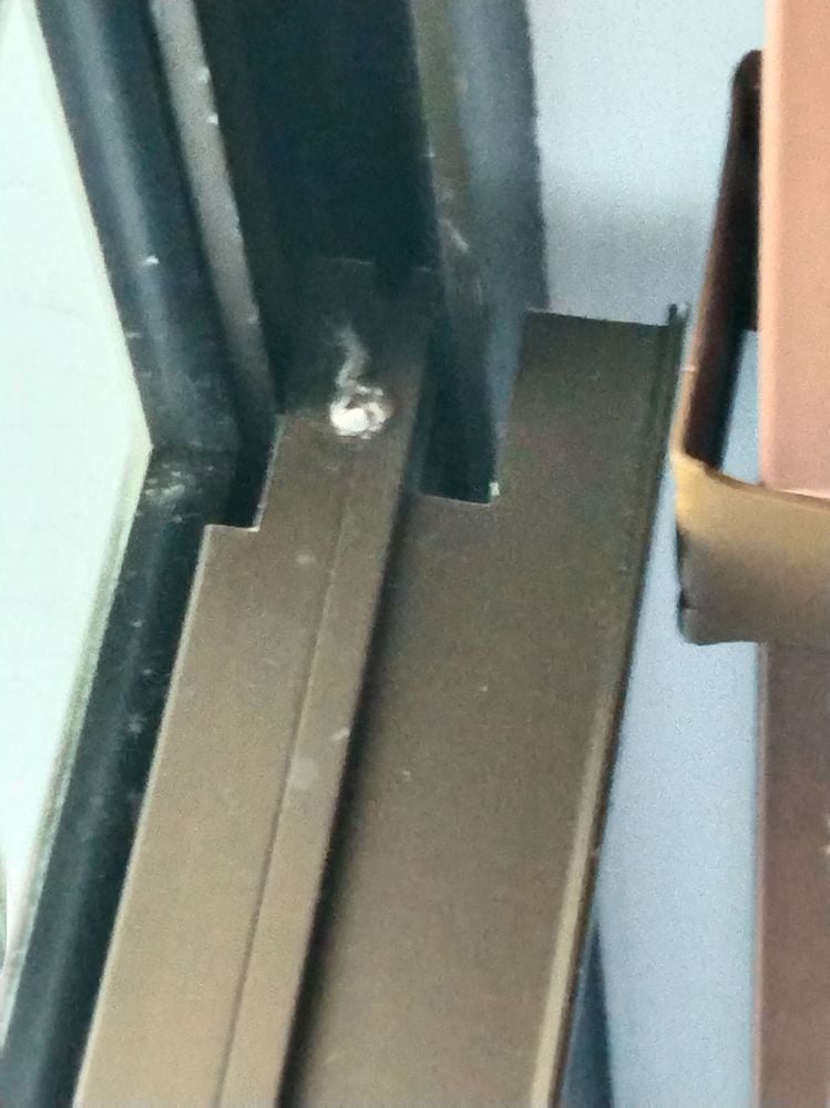

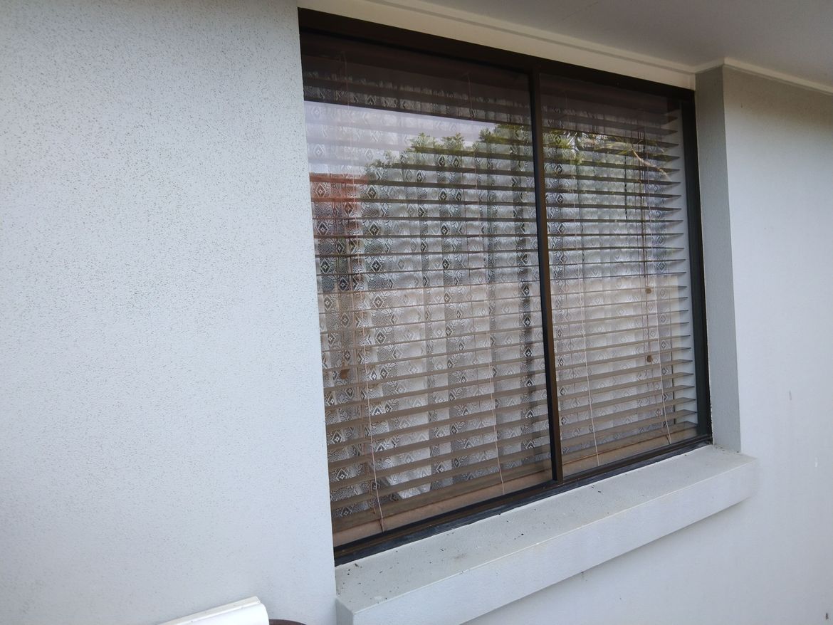

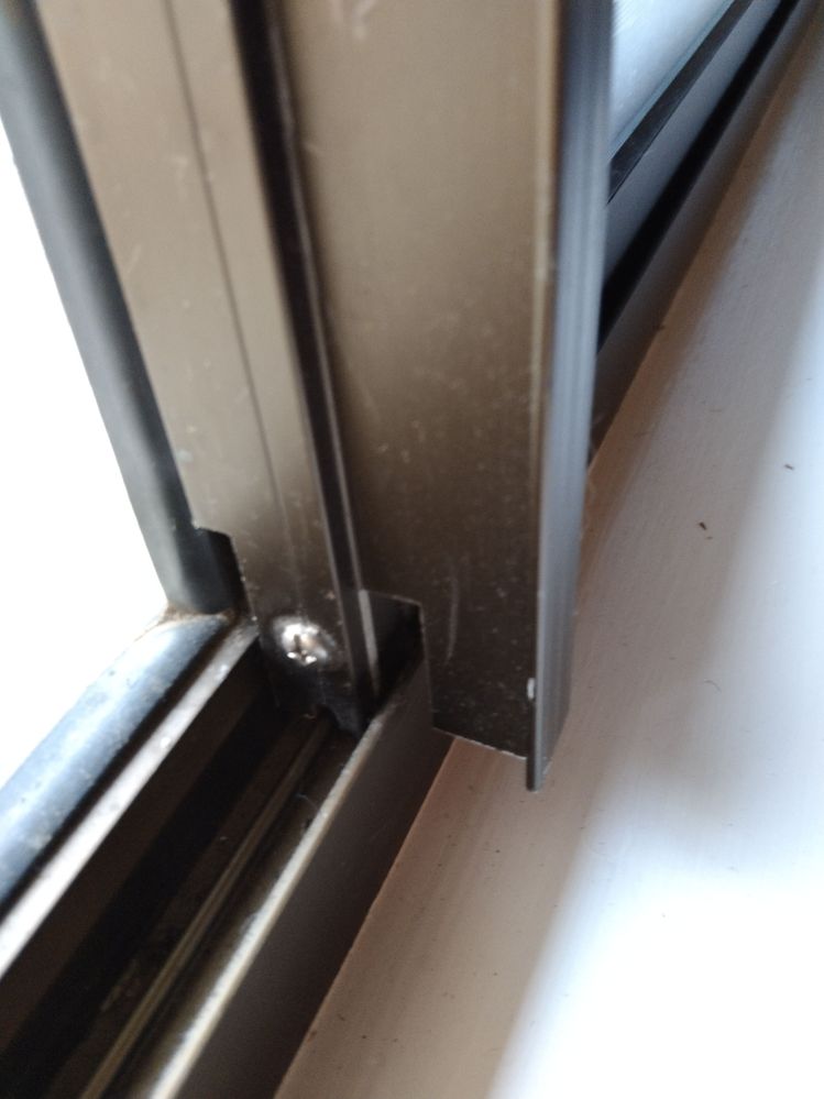

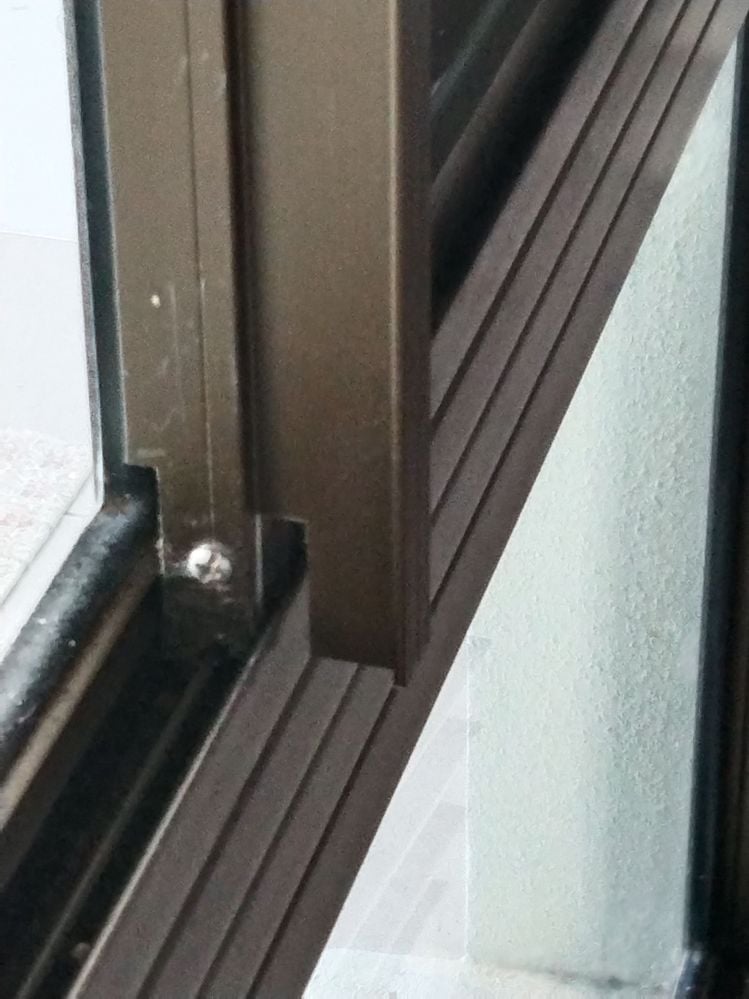

The photos I took of both openable and permanently closed windows look the same to me so hoping someone can help. The closed windows are all on the left hand side, where visibility is poor so this might be for added security. Openable windows (kitchen, bathroom etc are all on the right hand side with a clear line of sight from the neighbours.

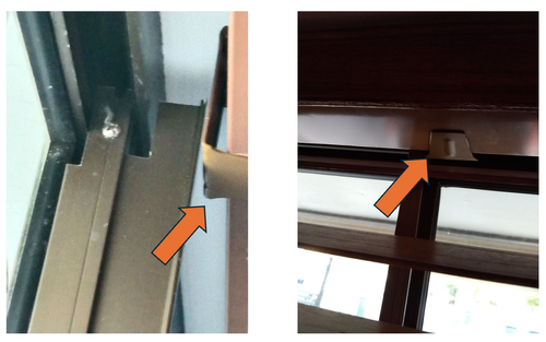

The last 2 photos show a metal piece at the top on the front lounge window which seems to be what's causing the problem for the window I can't close. The first photos are of the bedroom and side lounge window which can't be opened at all. (The lounge window was actually just plastic before I got this changed to glass).
I did try, but I can't budge these screws at all.

It's hard to know for sure, but those side screw are possibly ones that secure the side of the window frames to the top and bottom sections. If these appear on all windows both openable and non-openable then it's more probable and In which case aren't meant to be removed. Having said that they could still be simply concealing a locking mechanism not in use as it's uncommon for large screws like that to be used to hold manufactured frames together.
If they are only on the un-openable ones, then they could be part of a window lock mechanism. If they are 2nd story windows it would be more likely as part of privacy and/or safety due to overlooking regulations to the neighbours. The glazing would also be semi-transparent. They would also have this type of glazing on that left side even on the bottom for privacy if the neighbours house was 2-story to stop them looking in on you. This would have been done by the previous owner as there is no law covering that.
Do any of the opening windows have a pull to slide open handle on them? Can you supply a full window shot from the inside?
Is the metal bracket I have highlighted in the photo the one you refer to for the windows you can't close? If so this is actually just a supporting bracket for the louvre blinds. It may be bent out of shape causing the issue.

Sorry I'm unable to be more concise as it is difficult to get a clearer understanding from photos alone. I would still have a go at removing the two screws just on one window. You might need a longer shafted No 2 Phillips head screwdriver to get a better grip in to the screw head as its off on a slight angle. Then apply a lot of pressure as you attempt to unscrew at least two on one of the windows. This set is reasonable quality and has a lot of other handy screwdrivers.

That piece in the middle at the top is for the venetian blinds. There is usually a toggle handle half way up the sliding window on the side that butts up against the wall side. This is what latches the window closed. I cant see it in your photos as it seems to be missing? The screws you show conenct the window frame taht is holding the pane of glass vertically to the horizontal part. I dont think they are stopping the window sliding.

So those silver screws in the photo are to hold the bottom side window frame to the bottom and top window  frame so no need to undo them.
I think @Nailbag  is on to something RE  "Is the metal bracket I have highlighted in the photo the one you refer to for the windows you can't close? If so this is actually just a supporting bracket for the louvre blinds. It may be bent out of shape causing the issue."
