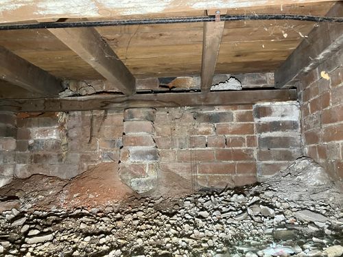

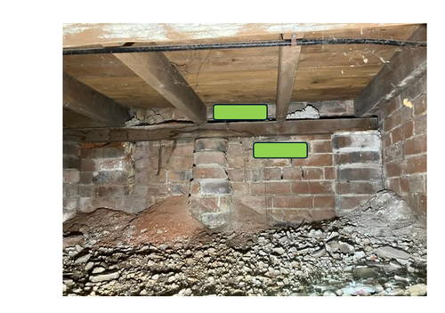

recently purchased an 1890’s rural home with rising damp.
It is double brick with a veranda around external wall. It also appears to have slate acting as a damp course.
My question is as I am able to access all walls through the underfloor should I use dry rods to stop this issue?

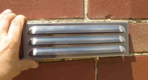

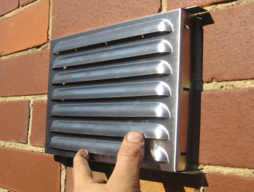

I would probarly go downthe route of more ventilation under the house, something that allows cross breezes to dry out the ground and brickwork so the damp doesnt get a chance to contine up the brickwork. In an older place I would definently get someonequalified to install open airvents as the state/way the bricks have been laid could cause structual issues if disturbed. I would even go the route if install under floor exhaust fans to draw air through the space if it was bad enough.
Re: How to stop rising damp?
HI @baselofbakerst I've actually not heard of dry rods, but I do know that increasing cross ventilation under your house can make a significant difference in reducing rising damp. This is done by replacing one or more bricks below floor level, either between the floor and joists or below the bearers around the house and above ground level. They are available in several designs and a relatively easy DIY project.

Those hot rods look quite intriguing... without actually getting to inspect one they appear to be a porous (or perforated) tube which provides an alternative exit path to moisture within a wall structure, clever in theory but I have never used/installed them.
I would concur with the suggestions for additional ventilation in your subfloor and have noted solar extraction fans designed specifically for this purpose but would suggest the passive grilles are significantly more please aethsetically.
