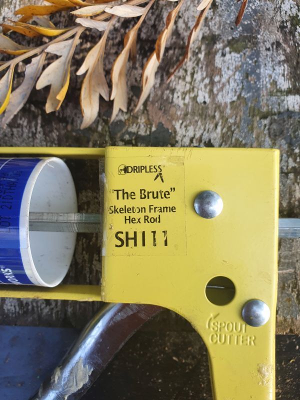

Alternately - you can buy DRIPLESS guns - I bought this one from Bunnings.
Dunno how they work (magic?) - but they do not drip, brilliant!
