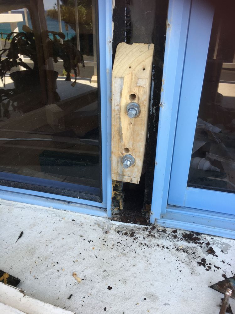

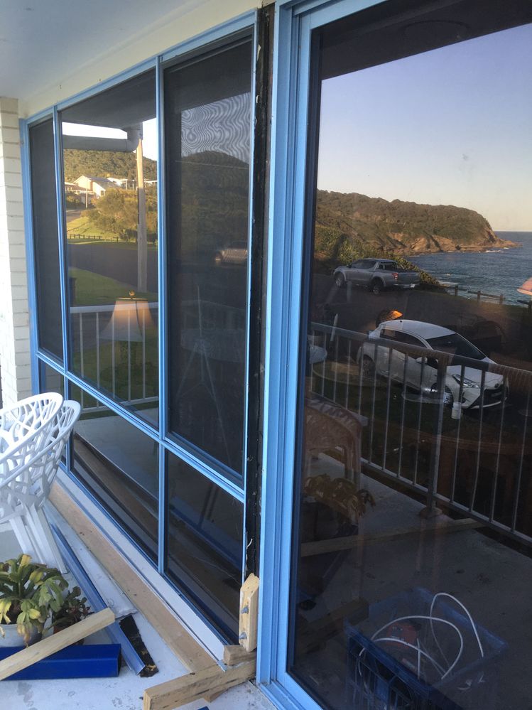

I have discovered the posts holding up the roof at the front of the house have rusted off at the base. There are 5 all up but I have started on 2 which are the worst. They are spaced about 2.4m apart and have a set of sliding doors between them and windows on each side, all floor to ceiling. My plan is to cut them off near the top and have new galvanized bases welded on (these have been fabricated and are 1.9m long). Originally, the posts were set onto Hebel Powerpanels. The outside is a verandah with a slurry of concrete sloping to the outer edge. This means the top of this is higher than the inside of the house and the base of the posts. My plan is to set the new post about 40mm higher and also move the door set and the window sets up 40mm. This will create a "hob" (?) which should keep the water from entering the house. What should I use under the posts to make up that 40mm? Any other suggestions? Builders don't call back.

Thanks Mitchell. The builders I have tried to contact are not interested in answering the phone or calling back. Not just for this job but also a previous couple. Thanks for the recommendation of the Grout. I am guessing the tops of the posts are fixed to the RSJ with bolts and the bottom with Gal screws into the Hebel. I have no faith in the builders as the posts are not Gal and we are opposite an ocean beach. Also there is no flashing on any of the external doors or windows, plus other issues I am dealing with. My intention, with consultation with a welder I have found, is to put a slieve in the posts at the joint to add support and make the weld stronger. The base I intend bolting down with Gal screws into the Hebel with epoxy glue ( I used it before ).
re. the base for the 40mm hob. I was thinking of strips of fibre cement sheeting with a grout between. Perhaps 2 at 20mm thick. I was thinking of putting the posts onto these but I like the idea of your Sika Grout. Perhaps I will use the Sika Grout as a step for the posts and put Fibre Cement sheeting under the doors and windows.
Thanks Dave, I have covered some of your concerns in my reply to Mitchell above. I have 2 Acro props from Bunnings ready to go. I intend checking for sagging but have not yet worked out how. Am thinking string line.
