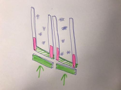

Here is a quick sketch of the idea.
The green diagonal strips are the piece sof timber that you will be removing (Hope I have that right)
The solid green pieces are the new timber to replace the old rotted timber. These are the full width of each of your doors.
The will be slotted up into the space once removed.
The pink vertical pieces are new pieces of tin/sheet metal cut to size a little smaller then the width of the timber edge aroun 30-40cm tall. These can be painted black.
You could use screws to attach the metal to the timber to secure (6 top and 4 for the new piece) or use bolts all the way through  both sides of the metal fixings
If you feel that the door may get mistreated with boots holding it open then you could go down the track of the tin being cut in a giant U across the bottom width.

Thanks for the clarification @joeth.
It would be best to install either biscuits or dowels when joining the bottom section. Adding additional brackets wouldn't be a bad idea also.
