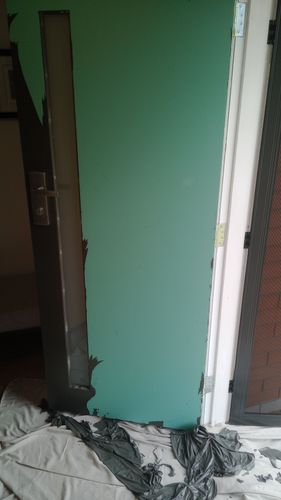

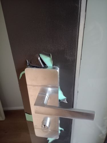

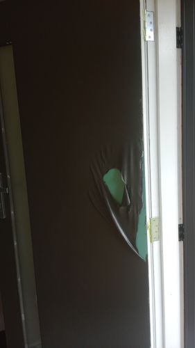

My builder installed a new door then slapped a quick coat of paint on to weather proof it. I was on holidays. I can back to do the final coat and noticed some imperfections. Decided to sand before painting and the paint started lifting off like a skin off custard. Pulled the whole thing off, lightly sanded then repainted and now when I took the tape off the handles the whole paint layer starts lifting again and will need removal
. I am using Dulux Weathershield. I was told the door is pre-primed. What am I doing wrong?

Hi @TomH1,
I'm sorry to hear you've experienced issues painting your Duracoat door.
Duracote doors must be primed before applying your topcoat. Although Dulux Weathershield is a self-priming exterior paint, due to the slick surface of the Duracote, it must be primed separately first. I suggest using a primer such as Zinsser 1L Bulls Eye 1-2-3 Undercoat Primer Sealer Stain Blocker. It's a water-based primer which makes it easy to work with and you only need to use water to clean up the brushes.
The delaminating of the paint is due to having no primer, but you might also like to reconsider using a soft paint such as Weathershield which is typically designed for walls and surfaces that don't readily receive impacts. I recommend using a much harder water-based enamel paint similar to Dulux Aquanamel.
