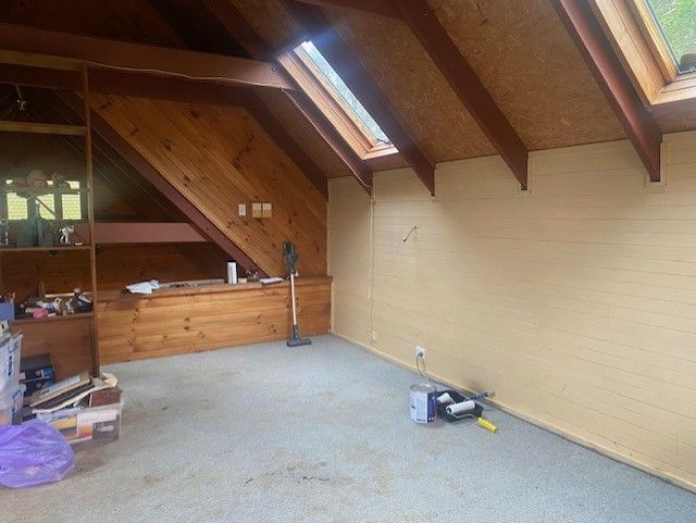

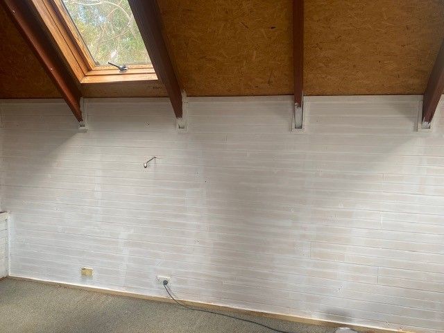

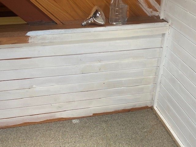

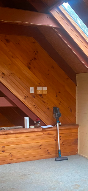

I am painting our entire wooden house (about 40 years old). Some is painted and some is stained. I have already started some sections and have some questions/concerns. Where I have painted the stained section, the undercoat has started to yellow/discolour. What am I meant to put on there before the undercoat?

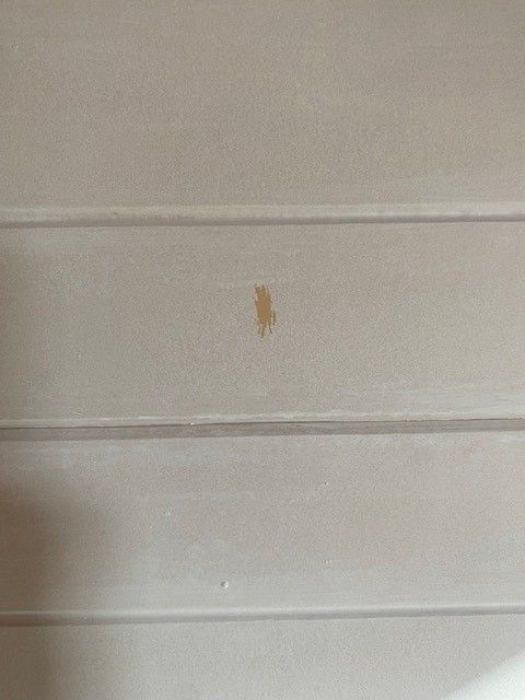

The painted section is also not adhering, I think it is oil based and I asked the bunnings paint section man and he said the undercoat I bought would be fine to go straight on and I didn't need to sand the wood. I have spent a lot of effort painting this section and the paint just scratches straight off, it's not sticking to the wall at all. Is this normal? was I meant to stain?
Please help! Pictures attached. stained wooden wall.jpgPainted wall.jpgpainted wall 2.jpg

Was it raw timber that you've painted the undercoat over, or did it have a shiny surface?  Would you be able to take higher-quality photos of the same timber elsewhere so I can try to ascertain whether it is coated? If the undercoat hasn't adhered correctly, it's likely that the surface wasn't compatible with being coated with a standard paint. We really need to work out why it isn't bonding before we apply any other layers.
The sealer would likely require two coats to block the stain out fully. However, first, we need to identify why the undercoat didn't bond, and secondarily, we need to decide whether this coat needs to be sanded off and the underlying timber prepared to accept a coating. It sounds like the timber needed to be sanded first to remove a coating on it that prevented the undercoat from soaking in.
