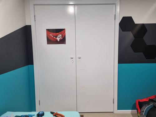

Success!
Thank you for the advice. No distractions today and got the knobs on with no problems.
I put them in 7cm from the edge of door.
Cut the screws with pliers, used my child's school ruler, makita drill & a drill bit I had was perfect size.
I will have a go at filling and smoothing the holes from the old handle. What could I do to neaten up the doors from patching?
 Thanks again:)

Nice work so far, I'm glad to see you've got the new handles installed.
To tidy up the old stuff, grab a Cork Sanding Block and some 120 grit sandpaper and give the raised screw holes and filler a sand.
Once the raised screw holes have been sanded down and are no longer raised, apply some Selleys Spakfilla Rapid Gap to them using the provided spatula. Once dry, give it a sand.
You can then paint over the patches to blend them in with the rest of the door and have a fantastic finish.
