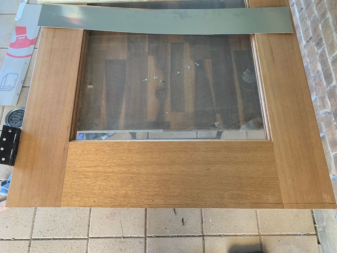

Hi all @Nailbag @Dave-1 @JacobZ @Jewelleryrescue ,

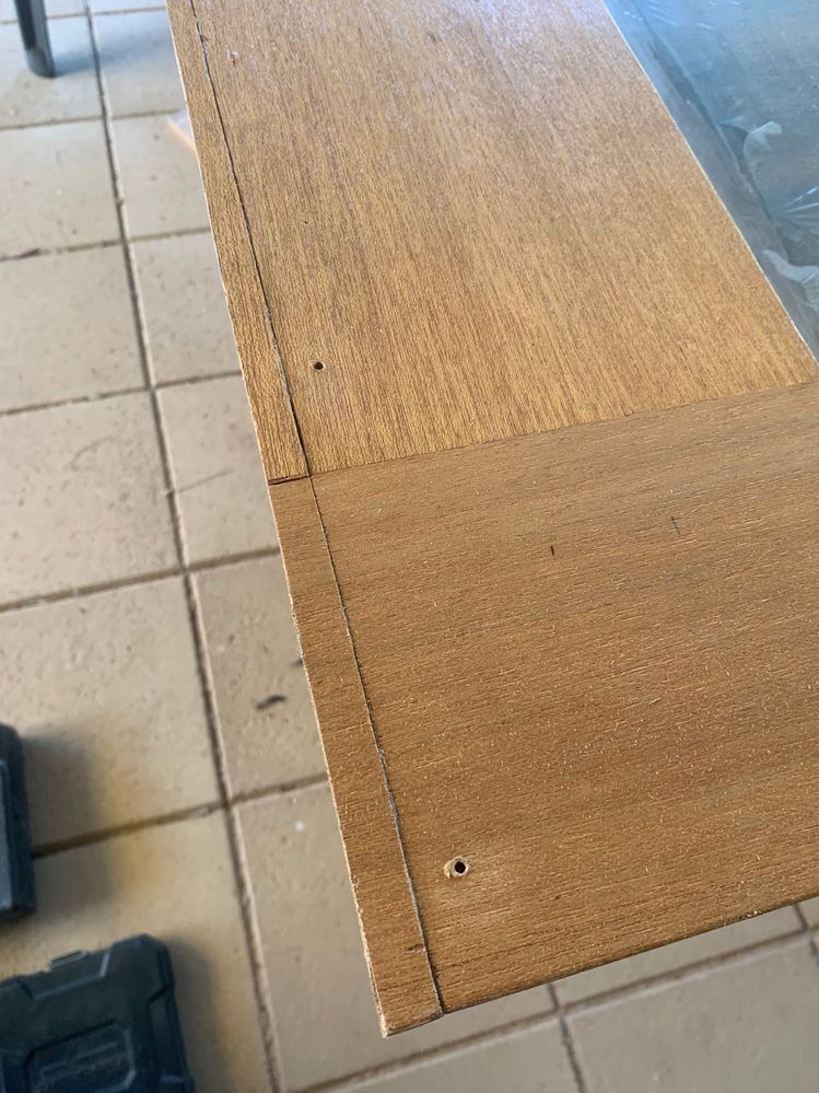

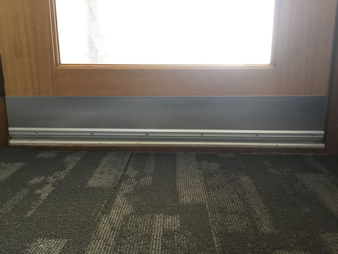

Just wanted to say thank you for all your advice. It was excellent and I was able to repair the door by using the offcuts which were laying around, gluing them back on and then re-cutting to the correct size. I sealed it with two coats of sealer and then used an aluminium sheet to provide strength and hide the glued edge before refitting the weather seal. I really appreciated all your handy tips and I was able to go in prepared and confident with a plan. I’ve provided some updated photos. Thanks Legends!B9410A41-E722-48DA-B9A4-A29806D13A30.jpegC4A5E0C5-FA18-4C8E-869A-10A7D9776110.jpegimage.jpg

You've done a magnificent job here and produced a result that you should be very proud of.
I'm glad to hear the advice you received gave you the confidence to get stuck in with the repair.
Congratulations on a job well done.

Thats awesome news @JSLawrence and well done on the very neat workmanship. Thats worked out to be a great solution and it worked out in the end.

Cheering! That looks brilliant and best of all you did it yourself! :laugh:
Certinaly has a professional look to it now :smile:
