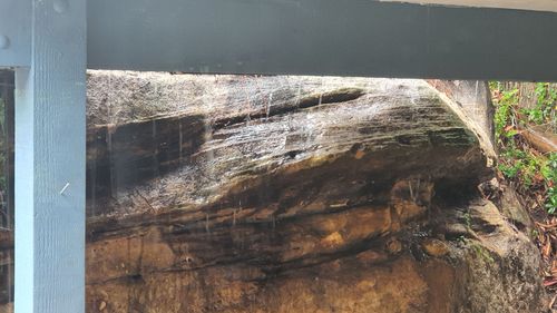

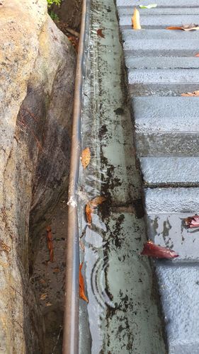

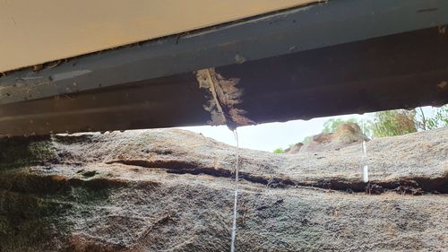

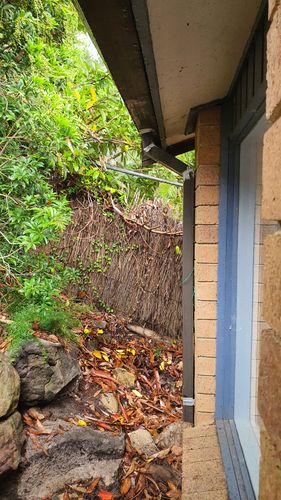

I have issue with my gutters and one of the doesn't its job at all. It's 415cm long with no/ wrong slope. Water does flow through the gutter and keep overflowing. Also it's 2 pieces which are not sealed properly.
I want to :
1- replace it with a new piece instead of 2 pieces if it's possible
2- fix the slope
Never done it before but want to give it a try
Thanks
Sam
