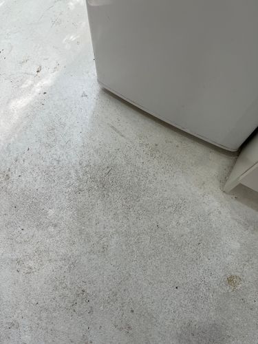

Hi all, I have a tiny (shed) home which has concrete flooring that has been primed and painted white. In a few areas, the concrete is quite rough and very hard to clean. Dirt often gets trapped into the grooves and it looks terrible! Would love some advice on how to fix this issue either by smoothing out the concrete or covering it somehow. It’s a small space so a rug is not really an option sadly. I know white floor is hard to keep clean however in the smoother areas, it’s much easier to vacuum and then mop. Any advice would be greatly appreciated!

It appears the coating has been worn through in the high spots due to them receiving more abrasion. Now that the paint is compromised, there are limited options to rejuvenate. After cleaning it thoroughly, you could take a gamble and paint over the existing coating. However, your new coating will not be covered under warranty as it will only ever be as good as the coating underneath it. There's only one product I'm aware of which is designed for this situation, and it's the Rust-Oleum 3.78L Concrete and Garage Recoat Primer and either Rust-Oleum 3.78L Armour Grey Concrete And Garage Floor Paint or Rust-Oleum 3.78L Battleship Grey Concrete And Garage Floor Paint as the top coat. Unfortunately, the topcoats for this primer are only these two grey colours.
You could re-surface the area and grind back the concrete to a smooth surface and remove the roughness. If you were to go to that extent, you could paint again in your preferred choice of colours as it's bare concrete.
