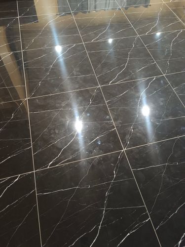

i have attached pictures
Re: Black Procelien Tiles
Hi @SaviS,
Those are oil marks from bare feet; you can see the partial footprints in some areas. If someone with bare feet or a pet walks over the tiles after you have cleaned them, they'll pick up these marks immediately. Unlike white tiles, these oily marks really stand out on black tiles. White tiles pick up these marks as well; you just can't see them.
It sounds like you might need to try and minimise the number of bare feet on this floor. You could implement a socks-on policy, get everyone a comfy pair of house slippers or add a carpet over this area.
