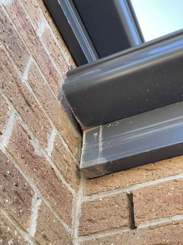

I have an issue with one of the rain pipes in a corner of my roof, rain water drops from there and comes on a Window frame underneath. Take a look at the picture and suggest me what can I do about it.

Hello @sper
Thank you for sharing your question about your leaking gutter. I suspect that the silicone sealant on the gutter stop end has deteriorated. I suggest putting a new bead inside with Selleys 290ml Black Storm Waterproof Gutter And Roof Sealant. Be generous with the sealant and make sure to cover all the corners and parts where the gutter stop end links to the gutter.
Please make sure to wear gloves and safety goggles when applying the silicone. When working on a ladder, please make sure that you have someone holding it steady at the bottom and that the feet of the ladder are firmly planted on the ground. Take all necessary precautions when working on your roof's gutter.

Hi Eric, I went up to apply the seleant but figured out that it’s missing the stop end. I am not sure which stop end and where to get it from and if I would be able to fit it.

Hello @sper
Can you please take a photo of the end of the gutter from the top? This will give our members an idea of how the gutter was sealed at the end. We can then make recommendations on how to proceed.
Before you come down from the ladder, can you please take some measurements on the width and height of the end of the gutter. This will help us track down the part you are after.

How unusual, @sper! Looks like they just forgot to add the end cap.
There's a good chance this COLORBOND 115mm LH Quad Gutter End Stop will suit, but you'll likely need to double-check once you return home.
Installing a gutter end stop is a relatively simple process. You'll need a drill driver, drill bit, silicone, rivet gun, blind rivets and a ladder.
First, clean the sediment in the gutter thoroughly. Place the end stop at the end of the gutter, ensuring it is level and aligned with the gutter edge. Mark the position of the blind rivet holes on the end stop and onto the gutter using a marker. Use a drill to make holes through the gutter and end stop at the marked positions.
Apply silicone on the inside edge of the end stop. Make sure to apply it down the back, across the bottom and up the front edge. Align the holes on the end stop with the holes on the gutter and use blind rivets to fix the end stop position. Once the end stop is installed, you can add an additional bead of silicone on the inside of the gutter for extra protection.

Hi @EricL @I followed your advice and it has worked brilliantly and I am so happy 😀. Post my reply late though as I fixed it quite a while ago. Nonetheless good to share feedback here. One thing I had to get was tin snip as needed to cut the cap to the size.
