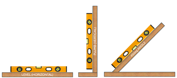

When an object is perfectly horizontal it's known as being “level”. Most models will also check if the object was perfectly vertical like when installing a post. This is known as being “plumb”. Less commonly some can also check if an object is on a 45deg angle.

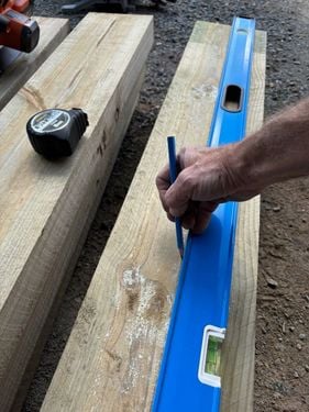

Their accurate straight edge makes them perfect for marking out straight lines, checking the height of new kit cabinetry to levelling soil before laying turf. I often use mine as a straight cutting guide when making long saw cuts through larger timber sheets or when trimming a new door to length.

Not at all, in fact they are a very easy tool to use. They have one or more transparent vials containing a single bubble within some form of coloured alcohol which, is where “spirit” comes into their name. When the bubble is centred between two-line markings, the object will be level, plumb or at 45deg.

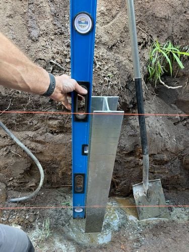

To check the level of an object simply rest or hold the level on the top while adjusting its angle to get the level bubble centred between the two lines. To check if an object is plumb (vertical), then rest the level against the side of the object with one hand as you adjust them together with the other until the bubble is centred.

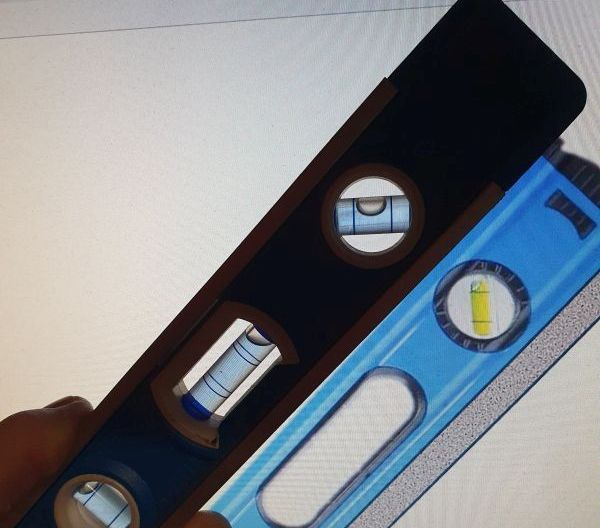

The liquid within the vials come in various shades of yellow, green and less commonly blue. Being able to see the bubble in varying light conditions and angles is obviously pretty important. So, when choosing a level, hold them about in various angles and heights to see which bubble you can see easiest.
For me, I find that mid-strength greens provide the best combination of low (indoor) and bright (outdoor) light conditions. If most of your applications will be indoors, then there are models that feature a backlight to make viewing the bubble much easier. Also take not how quickly the bubble moves. Slower moving ones make using the level easier when making minor measurements.

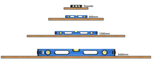

The longer the level the more accurate the measurement will be over longer lengths. In other words, if you needed to check a 2,000mm object a 1200mm level will give a more accurate measurement than a 400mm one. This why many DIYr's and professionals have more than one length level.

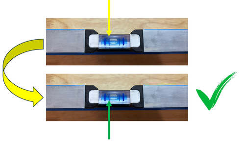

You can check the accuracy of a level pretty quickly and you don’t need a level surface.Simply lay the level down and check the position of the bubble. Then turn it 180deg and check it again. If the bubble is in the exact same position, then you're good to go.

If you’re just starting out in DIY, then I highly recommend a Torpedo level. These compact models are ideal for most applications within the home like hanging pictures and installing shelves etc. It fits in a drawer or be ready at hand in your tool bag.
Then as you expand your DIY projects further, a 1200mm long level would be my next recommendation as it’s an ideal length for most internal and outdoor projects. And personally, I would choose one with a plumb vial at each end in lieu of any 45deg vial as these are rarely used.
