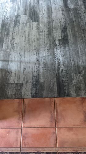

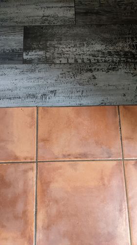

Hi all, when we replaced the carpet in the house we used tiles. The newly tiled areas are grey, and the existing tiled area is terracotta in colour. Is there a way to colour/resurface/coat the old tiles grey? Or do I need to replace the tiles to achieve this?

You could consider painting your tiles, and I trust you'll find this step-by-step guide useful: How to paint floor tiles. You must clean the tiles thoroughly and follow all preparation steps, including using an appropriate primer
Your painted finish will be durable and last a long time if you care for it and employ some preventative measures. It would be best not to walk on the painted tiles with shoes on, and carpets and hall runners should be used in high-traffic areas.
