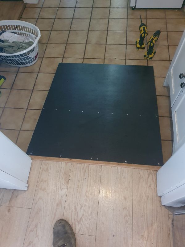

Heading for surgery next month and need a wheelchair ramp for an indoor step that I will only need for two weeks hence I'm using scrap plywood.
I'm trying and failing to cut an acute angle where the ramp meets the floor. The plywood is 1110 mm long and 900 mm wide with the step being 160 mm in height. I am an overweight man.
This is what I've managed - but I intended to cut the black line. Overestimated the table saw's capabilities.
Thoughts?
Advice?

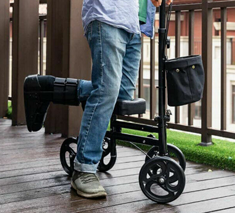

Since I started this thread I've been looking closer at hospital equipment for hire today - I'm gonna go with this...and not the wheelchair.

"I always thought plywood was a soft wood"
It's 19mm thick and there is a support midway under it. More than enough for an elderly obese man on a one leg scooter. 😁
And there is no drag-inducing carpet in the house.

The one-legged scooter looks to be so much more practical than a wheelchair. Your ramp looks very strong and sturdy, it's good that you got that angle you were going for. I know it is still a few weeks away, but I'm wishing you a quick recovery and hope everything goes well.

Self-propelling up this ramp is impossible and potentially lethal.

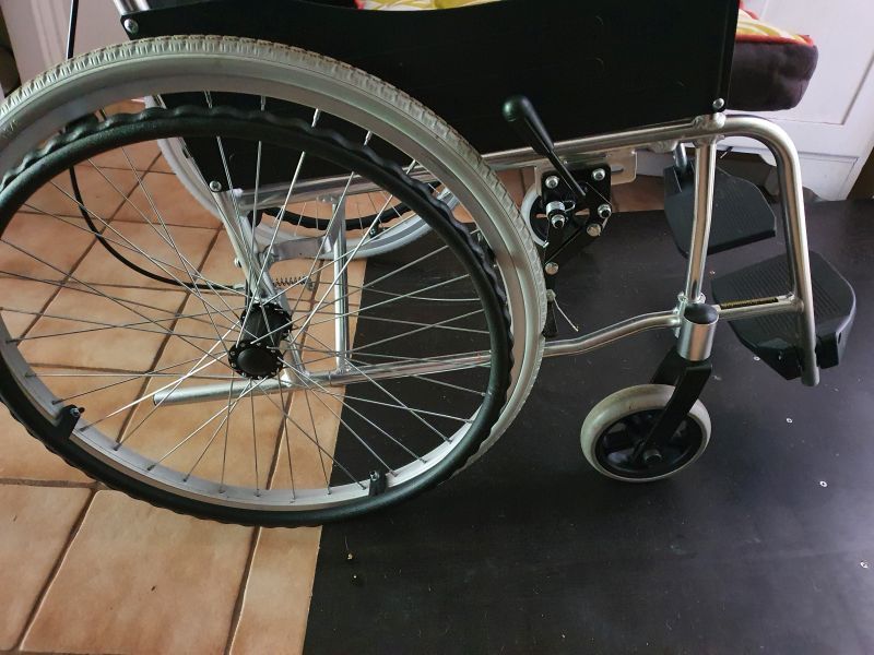

I test drove my wheelchair this morning and nearly ended up in hospital earlier than expected. I admit it's a cheap Kmart chair without the back supporting wheels but the moment you attempt to propel yourself up the ramp it's natural instinct is to flip you backwards. The centre of gravity is too high. Even when I manage to go very slowly up the ramp - the moment you let go for the next 'grab' you roll backwards. If you try a one by one hand technique, you simply roll to port or starboard. Of course, going down the ramp is not a problem by myself.
If someone pushes me up the ramp - not a problem. But self propulsion - impossible.
But it looks so easy!?

I've pushed thousands of people in wheelchairs - but next to nil experience being in one and It clearly shows with this failed ramp. A quick measurement reveals a 1:6 gradient (excessive??). It'll be interesting to see what research data you come up with. Ridiculous as it sounds, I'm rather shocked by this - even my youngest son who is fit, healthy and strong tried it and nearly ended up on his back.
As I mentioned above, there are no small support wheels and it's impossible to get a "run up" in the confined space.

It appears that if the overall height is between 35mm and 190mm, the maximum gradient is 1:10. For <35mm, the maximum gradient is 1:8.
