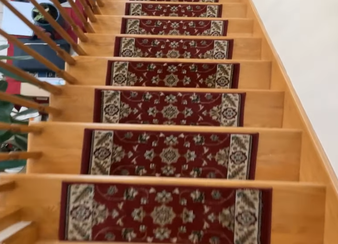

The outcome I am looking for is as the attached picture
Carpet rectangles glued to steps
Ready Made stair treads

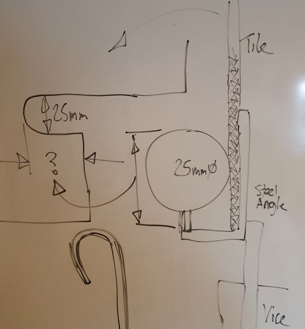

I still like the idea of heating the pipe so that maybe 2 or 3 bends can be made quickly whereas Cliff mentioned it takes 5 or 6 minutes each with a hot air gun. I think I would also like to hyper-flex the bend so that it 'pinches' the bull-nose and gives a nice tight fit.
My thought was angle iron and pipe welded together with lugs. The 'depth' would need to be measured based on the under-bite of the bull-nose.
Once bent - move it off to either side and use a hair-spray bottle of water to cool it quicker.
