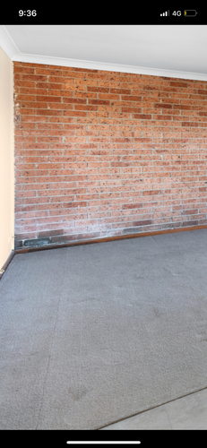

I’m looking for guidance on how to fix the damp issue on my newly purchased house.
The damp is on a lower level living room and is on the inside of the single brick wall that runs alongside a poorly constructed cement staircase pathway. On the inside, the damp is at a right angle to a stud wall which separates the living space from an underground storage room. More info below.

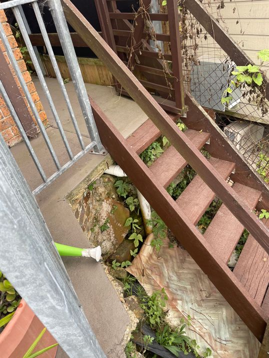

The concrete pathway/staircase is of pretty poor quality and has significant chunks that have fallen out along the steps (I don't think any steel/structural elements were used in the original DIY job unfortunately!). In addition to this, we recently noticed the concrete platform at the base of this pathway (see photo with wooden staircase leading off it, no photo of gap itself sorry) has a 3-4 inch gap between the concrete and earth. With this being the case, would you still suggest jackhammering and resurfacing as the best solution or do we need to start it from scratch?

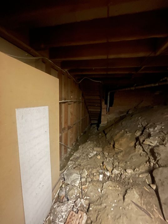

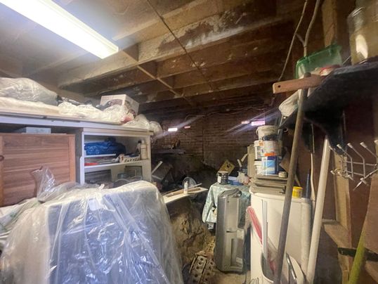

Sure, I've attached two photos below of the lower ground under house storage area (taken when we inspected the house, has a lot of the previous owner's stuff in there so not the clearest view sorry) where you can see a couple of vents that are quite old and not up to current standards. The flooring under there is open rock/earth with bricks placed on top, but there's no sub-floor or drainage system in place for any water getting into that room to divert it back out of the house.
Bottom of concrete pathway/staircase
Under house storage area (with small vents, not up to standard)
Other side of under house storage area

Thank you for the extra photos. I was hoping to see some air vents below the damp proof layer of your brickwork. The stuff that is stored kinda blocks all that area 😕 You should be able to see them outside but I have a sneaking susppision that may be burried. If you look at most brick houses you will see little little vertical slits just bellow floor level and the bricks may "jut" out a tiny bit (by 1cm)
The photo showing the end of the path kind of suggests that the whole area under the concrete may have been filled with rocks/bricks and then concreted over. This could explain how water would get under the slab and then make its way through to the room underneath via the brick wall. Having cavitys in the soil from builders refuse covered over was the reaon I had the water enter my garage.
What is under that old lino under the steps and is it wet? If there is water trickling it shows there is a path down the hill the water is following.
