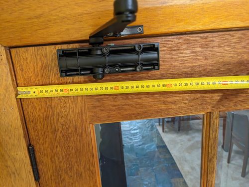

Hi @GeoffC,
I'm currently in the process of determining whether the opening resistance you're experiencing is to be expected with this product. Could you please verify that the closer was positioned per the diagram below? If it was positioned further away from the hinge, then this could be causing the opening resistance.
If the closer was positioned per instruction, I see no reason for an average person to experience difficulties opening the door. I also have concerns about your wife's ability to open the door. Due to safety concerns, doors should be easily openable. Please bear with me while I investigate, and if the product is not fit for purpose, I'll happily organise a return on it for you.

Many thanks for your patience @GeoffC.
I've been able to establish that the commercial closer you've installed can be difficult to open as it's designed to close doors up to 65kg. I suggest you look at the Ryobi Black Light Duty Domestic Door Closer, as it will be far easier to open.
I'll reach out via private message for further details so I can facilitate the return of your current closer.

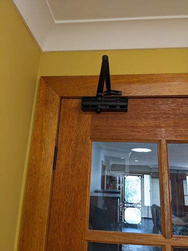

Hi Mitchell
I believe the install is correct but please check the attached photos
