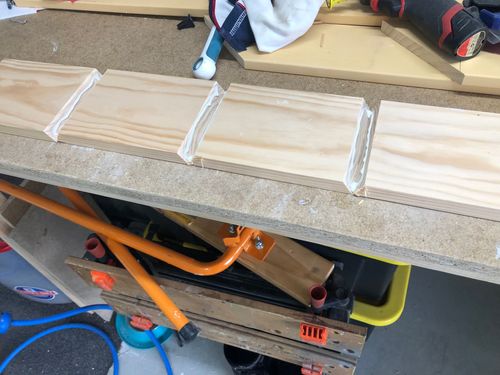

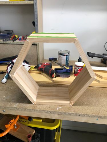

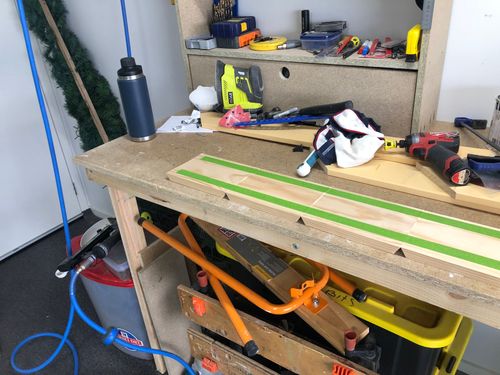

thank you for you kind words, I used a drop saw to cut all the sections it was set at 30 degrees, and the turn then upside down and tape them as below
then once I had them glued I used a nailer to just ensure there held together, I sanded them down and finished them off just using bees wax,

Did you have to use much filler at all, or is your saw just really accurate? I've tried making these before, and the issue I had was setting my saw to precisely 30 degrees. It's not a premium brand, and there is just a screw knob used for adjustment and an arrow indicator that points to the degree needed. It's somewhat accurate to maybe +-1 degree. Instead of cutting at 30 degrees, I'm cutting at perhaps 29 degrees. Since each cut is one degree out, each joint is two degrees out, and there are six joints overall. Two degrees out isn't much on a single joint, but using this tape method, that two-degree error compounds right up until the last joint. The last join is12 degrees out and nowhere near where it needs to be.
I might just need a more accurate saw or to find a way of clamping these up, so the error is split between the individual joins and not compounded until the last.
