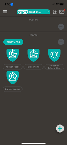

Hello, I have recently purchased 2 Grid Connect motion sensor/cameras (out and 1 outdoor siren from Bunnings. The sensor/cameras seem to work fine but the automation won't work for me (BTW - Arlec really - please - need to give some decent instructions on setting up the automation!)

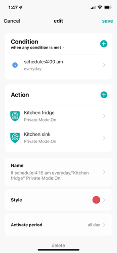

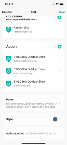

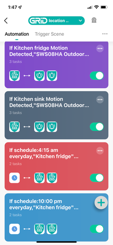

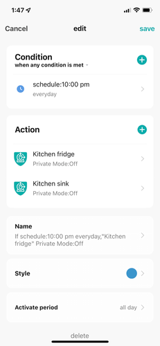

I have attached relevant screenshots. What I want to do is have the sensors (kitchen sink and kitchen fridge) activate the siren between 10pm and 4am if motion is detected. But after trying for hours to do this I cannot get it to work. The sensors/cameras and siren works fine as a standalone item but the siren will not activate when one of the sensors detects motion. Any advice appreciated.

Something doesn't seem right with your set-up, if you could possibly post pictures of the settings that aren't too small to read, that would be awesome.
